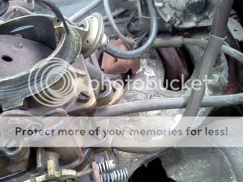

First pic has already plugged hole

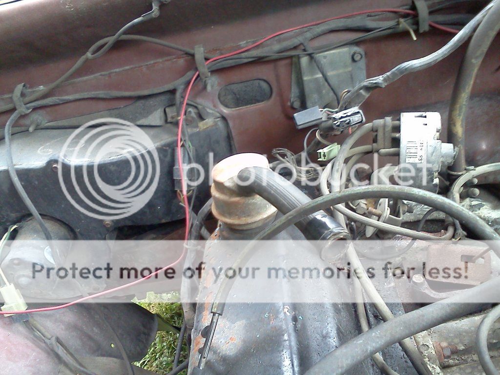

Second there's a hose don't know where it should go or if I plug.

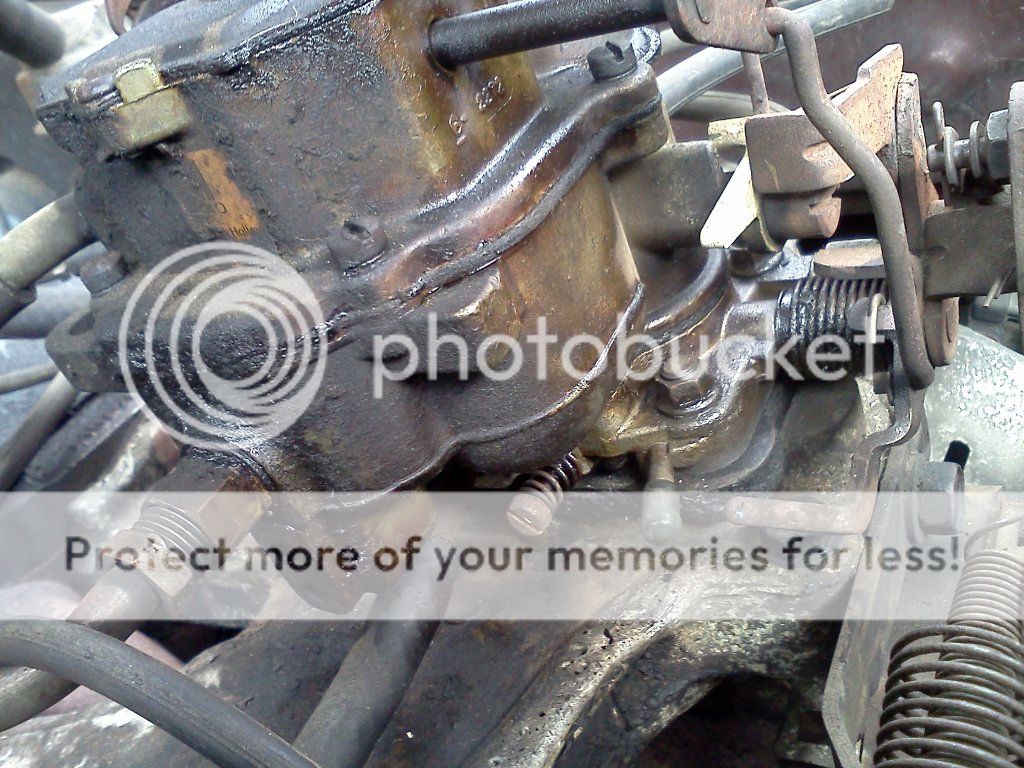

Next there'sa metal vacume diaphragm don't know what to do bout it.
Last the valve cover to air filter housing, my other truck has a chrome cap. Do I need
this going to air filterwith this set up?
Unplug it and hook it to the thermostat on the air cleaner.
Appears to be the EGR vacuum amplifier feed. If you want a functioning EGR valve, leave it hooked to the carb and let it run to the "hockey puck" bolted to the head.
THe metal vacuum diaphragm is the vacuum operated choke pulloff. It should be connected as shown in the diagram to a port on the back of the carb below and to the right of the EGR fitting.
Last the valve cover to air filter housing, my other truck has a chrome cap. Do I need this going to air filterwith this set up?
Yes. This is the crankcase air filter. It must be hooked up to the air cleaner. If you don't mind stinky fumes leaking from under your hood and polluting the air and stinking up the ca in your truck you can leave it disconnected, but why? Just hook the hose to the air cleaner and the vapors will be sucked into the engine.

I just went back and looked closer at the last two pictures you posted of the carburetor. The choke thermostat housing is broken. The tab with the bolt through it looks like it has rusted off. The housing is supposed to sit perpendicular to the cylinder head. If the choke thermostat is pushed back like than then (a) the choke linkage is likely binding and (b) the choke won't close all the way which will lead to a lean condition until the motor is completely warmed up. The engine likely won't go to high idle either.
I strongly recommend the CarbsOnly electric choke conversion kit discussed HERE. You want kit number 1232.
