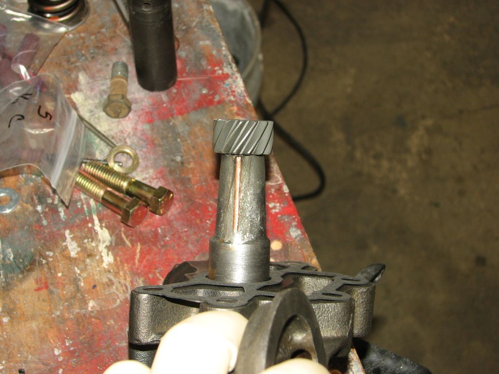

PostPosted: Sun May 03, 2015 12:25 pm
Online
Posts: 9479
Found a picture of one of Doc's oil pumps. Hope that explains it a little better.

PostPosted: Sun May 03, 2015 5:27 pm
Posts: 2132
Location: SF Bay Area
Thanks Rick, that's great, can't possibly miss the gear and it's sleek and elegant compared to older models...
