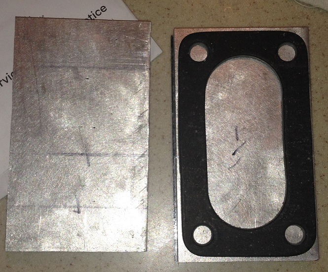

The webers measured ~0.4" taller from base flange to air cleaner mounting surface vs a stock 1920. It's going to be a nail biter... the stock air cleaner is tall, maybe 4"ish ? You can get narrow ~2" air cleaner elements for the webers. Push comes to shove, an offset hoodscoop may be in order. That would catch some attention.... off the deep end I go.
Found some 1/2" aloooominum plate. The good stuff, not sticky gummy aluminum but the denser type. Should thread nicely. How to cut it? Well.. ideally would be a bandsaw but no access to one, not locally at least. Jigsaw? Worked for thinner lighter stuff... tried it... on this heavy dense stuff I would be done by the time someone finishes casting an aluminum head. I read that a carbide wood blade has no problem going through aluminum especially if ran slowly.
I remembered I had put a fancy freud diablo carbide tipped blade on my cordless circular 4.5" saw. It runs slower then your mains powered 7" variety. Oh why not, what have I got to loose? A blade at the most. Took about 1/16-1/8" off in every pass, and we end up with this.
PostPosted: Mon Feb 08, 2016 9:03 pm
Posts: 2238
Location: Everett, WA
I have used a standard table saw with carbide tipped blades to cut aluminum. Set the rip fence and away you go.
PostPosted: Mon Feb 08, 2016 9:46 pm
Posts: 798
Location: Rio Rancho, NM
+1
Wood sawing equipment usually works fine on aluminum.
It will help a lot to use some cutting lubricant to keep the aluminum from building up on the saw teeth. WD40 works great for that.
--> The Diesel Corvette <--
PostPosted: Mon Feb 08, 2016 10:24 pm
Posts: 4194
Location: CA
I did have some spray lube handy. It didn't do much for the jig saw. I used it on the circular saw.
Table saw eh... I could see that working if things didn't heat up. Table saw blades are a bunch more expensive then these small circular saw blades. I had to cut in both directions. Dealing with small pieces like that on a table saw would be tricky.
Now to clean off the drill press table and see how I can bolt this thing down.
