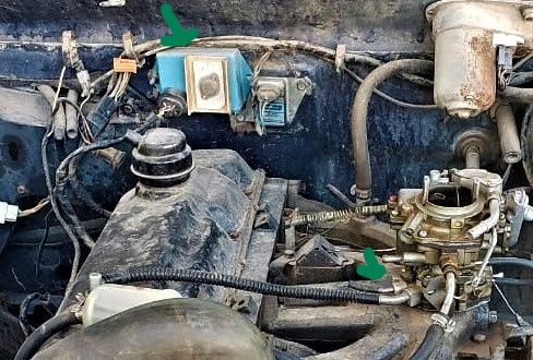

Thank you I will do that after. Get a heat shield and the fuel injection hoses. Also I attached a picture of my engine compartment maybe I'm missing something that simple that is causing the problem if you could take a look at let me know that would be great.

First thing I would do is get rid of as much rubber hose as possible, you're asking for a fire with that much rubber. I see you already have the hose draped over the top of the engine like Mr. Know-it-all's suggestion, but yet you still have a problem like I do, so what does that tell you about how well his idea works??
Maybe the shield is the answer? I don't know as I don't have one? Dims on that heat shield would sure be nice, but I'm sure that's asking to much from him to get anything like that posted on here?
Secondly, go to the car wash and hose all that crud out of the engine compartment, and the motor itself, gunk will help retain heat, and that's a bad thing! Also move the filter so it's in a up-down position, and get a metal one as plastic will melt and/or crack and also cause fire! Good Luck

Author:  Rick Covalt [ Thu Mar 10, 2022 2:29 pm ]
Post subject:  Re: Help with hard start when it's hot out.
I have no clue. Where is it located at? What does it look like?
This article shows the lean burn ignition mounted on the air filter housing.My 85 has it behind the battery. Distributor also would not have vacuum advance on it if it still running the lean burn system. The lean burn system can make them shut off dead without notice. Also can be hard starting...etc. You honestly probably have a couple things going on. Our clan has had 4 or 5 trucks all 82-85 models and have never had a hard start "hot" issue with any off them. And most of them have headers that put a lot more heat under the hood. There is just a lot more area under the hood of a truck than say an early A body. Can you look down the carb after it has set for 4 hours or so and see if the carb has gas in it. Is the accelerator pump squirting? Is it possible for gas to be draining back out of the carb? Just thinking out loud. Good luck & keep us posted.

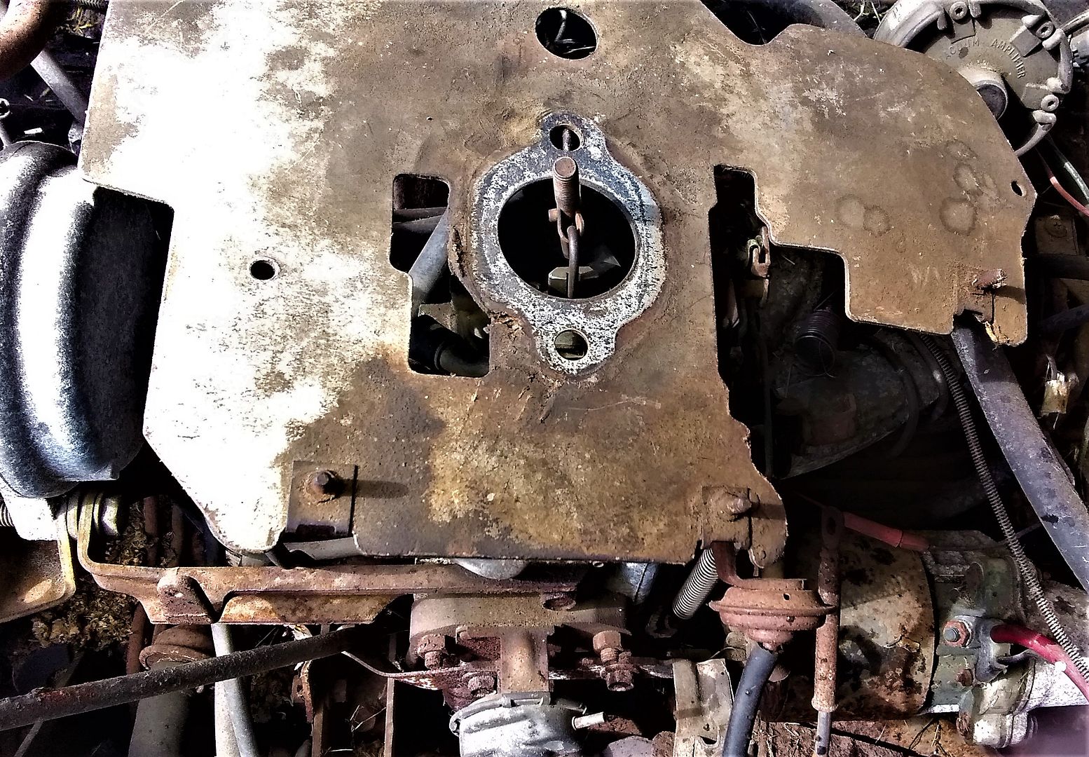

That fiber board was about .080 thick falls apart .Thin ply wood works best Here is home made for 1920 holley. No heat soak trouble after that. One thing to note 1920 fuel bowl in front easier to shield.Image

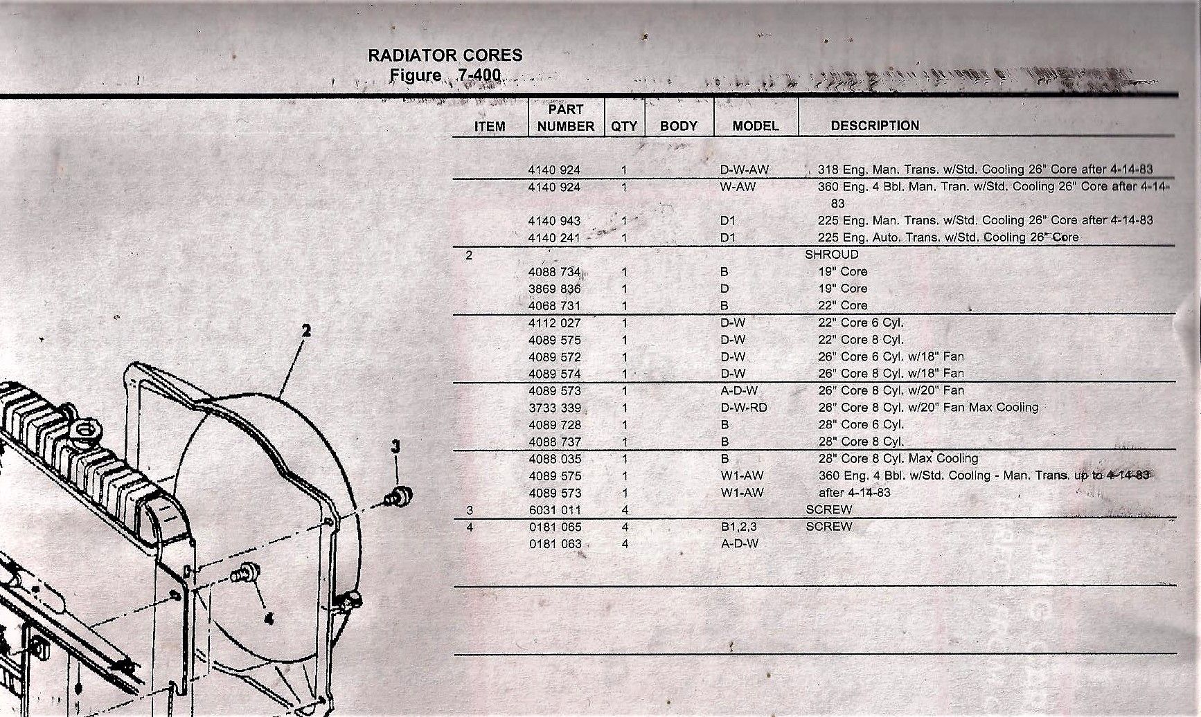

Do you have radiator fan shroud?. If not engine to hot at idle

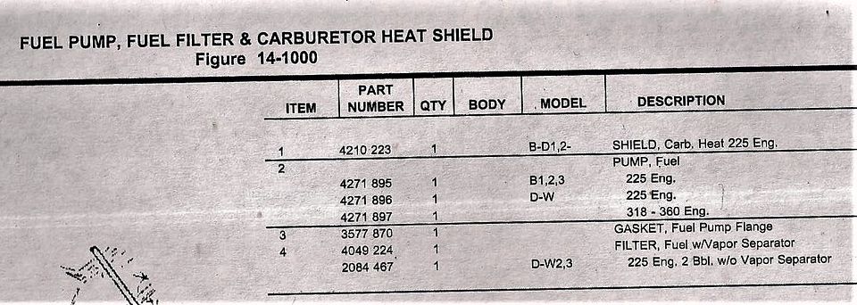

Your truck was built with 3 nipple fuel filter ,one return line back to tank sender, not the top of tank, thats the roll over vent valve. Image

At engine shut down residual fuel pressure will be bleed off by return line, and down hill slant on line will let fuel drain back to lower level so that it will not boil in fuel line at top of engine. Image

Dodge truck 318 no radiator shroud off road low speed operation . Engine and electronics ,carb and fuel line too hot. After market electric pusher fan in front of radiator with after run timer fixed it. Never did find shround.
