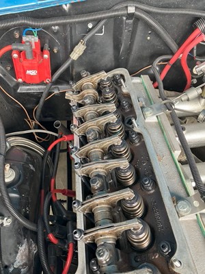

See anything different about #6 cylinder? Yes I had a rocker arm lock nut come loose and then the push rod fell out. Basically finished the run on 5 cylinders! :D I pulled the pushrod and the lifter and both looked great. Dropped the lifter back in and set the valve lash, then fired her up. All sounded well. So that was good news. If I would just have had 10 or 15 minutes I would have fixed it and made the Semi rd. Or I may have had a bye into the final. (Only 3 cars left) But didn't want to chance it.
Car had 4.56 gears in it so I knew the mph would be off a little. Plus the weather was about 100% rain in the air all afternoon :D :D
Car ran: 13:01 / 101.03
----------13.01 / 101.28
----------13.03 / 101.40
----------13.07 / 101.58

Glad to hear it was simple! Are those factory adjuster screws? Hard to see. If so, you might need shorter pushrods.
PostPosted: Tue May 06, 2025 5:07 am
Posts: 10397
Quick Fix! Great.
I thought it would be something simple as you kind of thought, as when you pulled it up on the trailer it did not sound catastrophic to me.
Lou, Rick swapped out to non stock adjuster screws, so the locknut/ jamnut is required.
