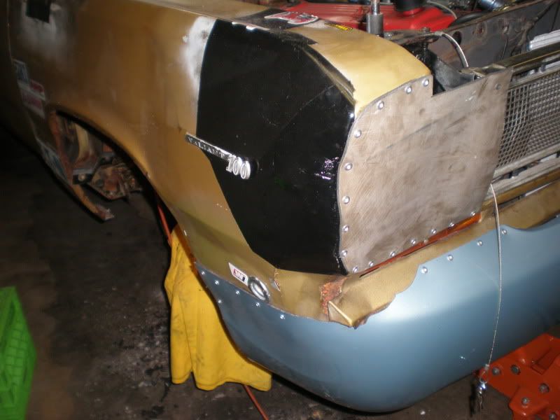

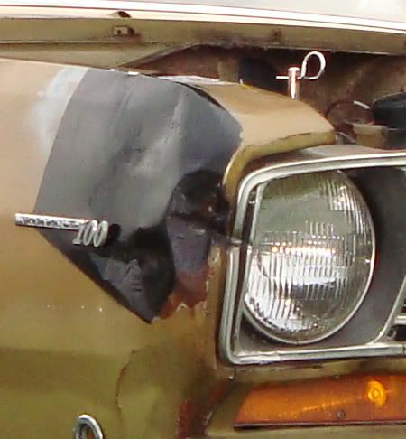

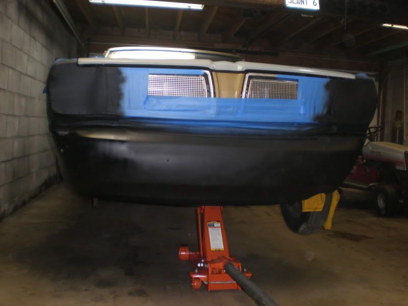

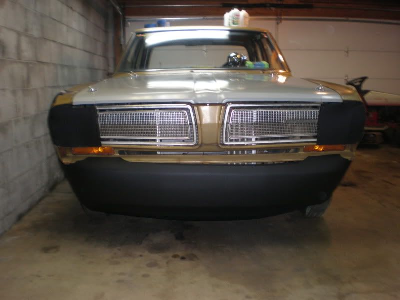

I got the Other "headlight delete" installed. This took a while due to the major Gash that used to be in the Headlight Bezel area of the RF fender - I tried to smooth and remove as much of the dent as possible, but it was impossible to get it all removed, but enough so that it's much less noticeable.
OLD:
Current:

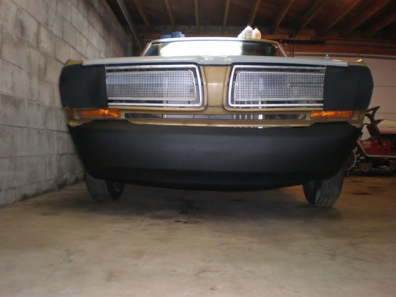

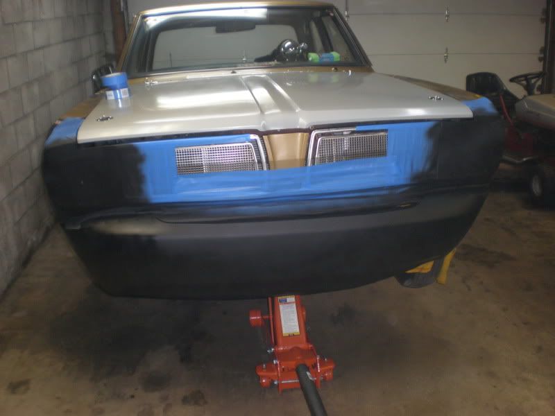

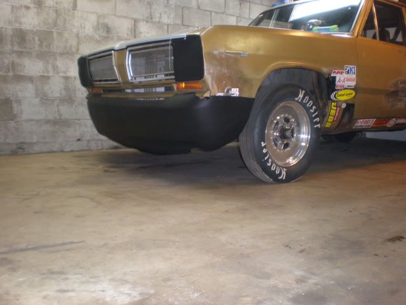

After everything was complete, I Painted the plastic pieces and then lowered the front of the car so that the Bottom of the airdam is 4" off the Ground

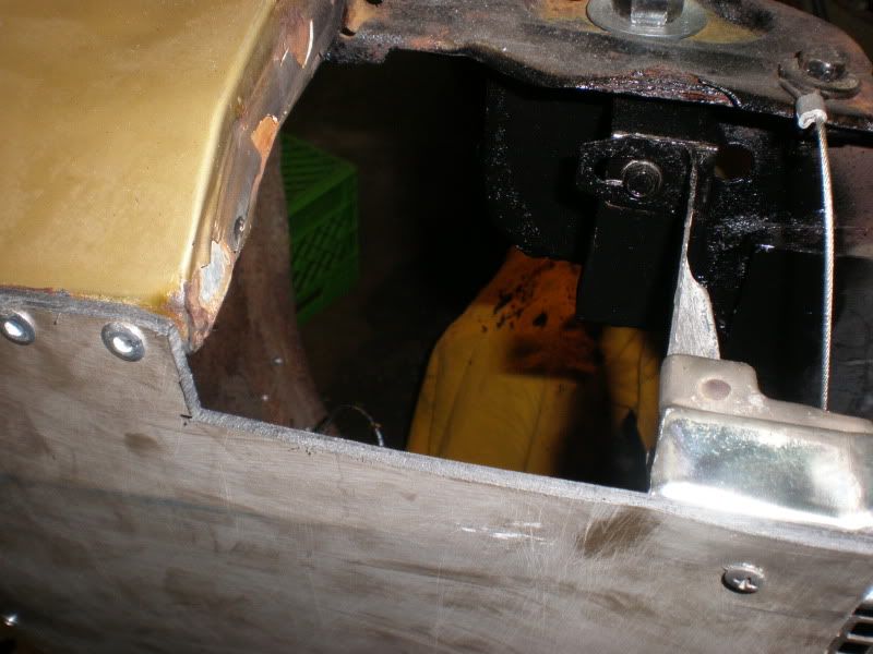

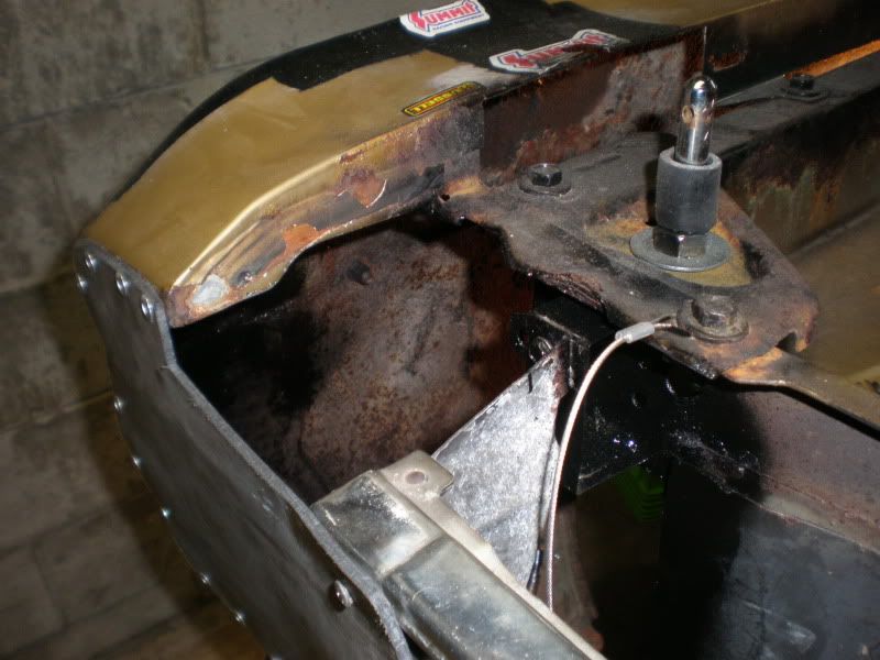

Here are some shots of the other work:
Completed job: - Just need to lower the front end now.

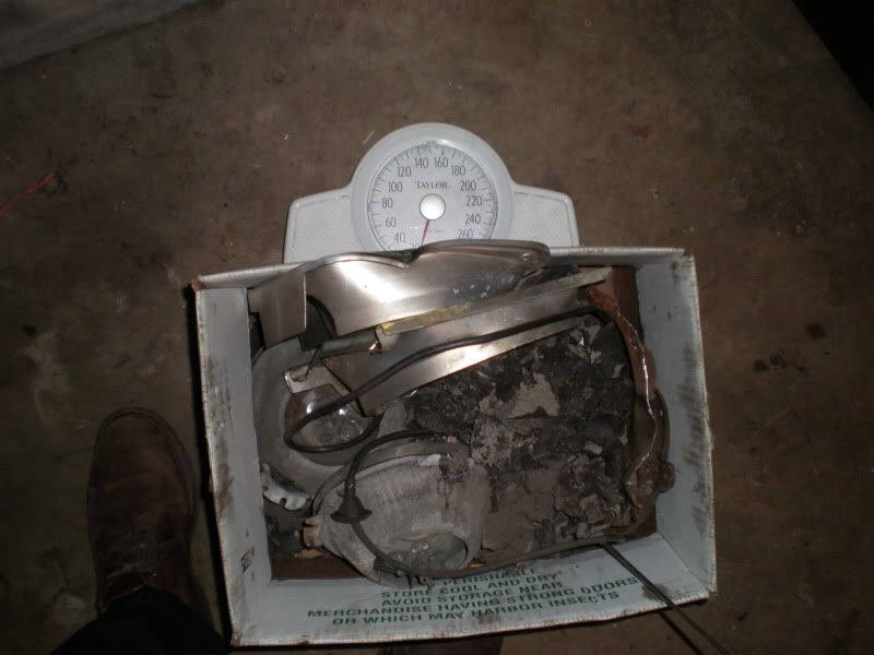

15More #'s of Headlights, Metal Bezels, antenna,, and All the undercoating removed from the RF Wheelwell area.
Total weight loss since thanksgiving is now 239#; add 48 for the Fiberglass and 10 For the Front airdam that leaves us at 181#
