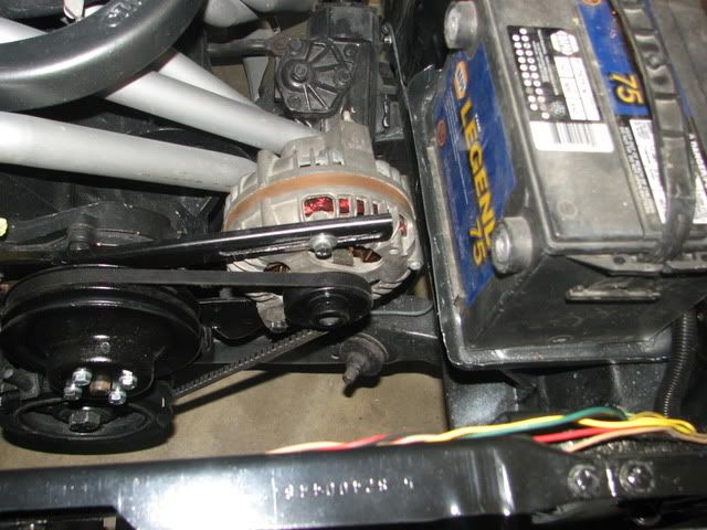

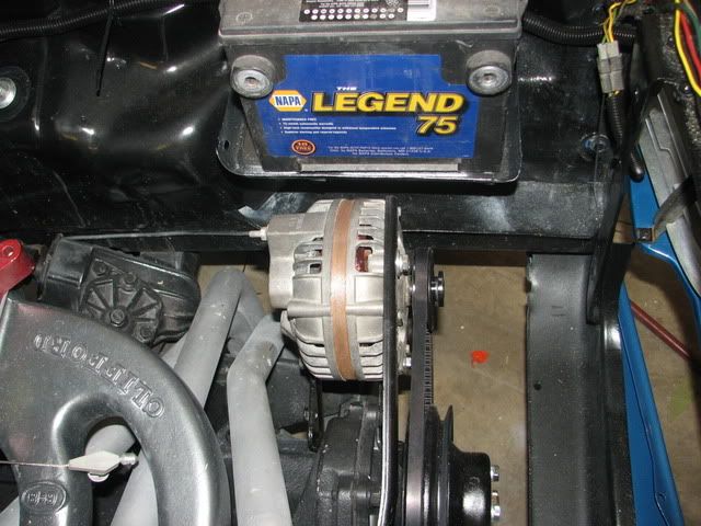

I was a little concerned about my battery tray fitting with the full sized alt. but it worked out fine.

Isn't that what trunks are for?

Yes, Will and it may end up there, but I am having a hard time deciding where to put the shut off!
