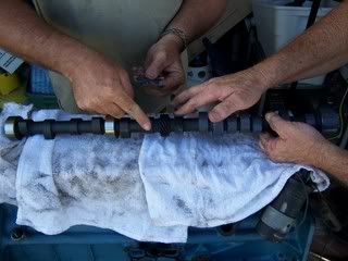

I suppose i'll see this weekend whether the has to come off but either way not a big deal. My erson camshaft showed up on my dorrstep today coming home from school ahh it feels like Christmas except with my money everything should come together soon only thing i'm iffy on is degreeing the cam in i've never done or seen it done so i may have to find some help on that one. Don't get me wrong I'd love to tear the whole motor apart put new bearing in get it acid dipped re ring it and replace what ever else may be worn but it's my only car and it needs to be running in the next week or two i'm tired of bumming rides. Plus the engine I scored from the junkyard looks magnificant no ridges in the cylinders from the rings no pits. it spins it's clean and besided it'll be another excuse to rip it apart again since it's not as bad ass as i would love.Slowly but surely it'll get closer to that never reaching perfect level.I'm dropping the head off tommorow hopefully that'll be done quickly to get .1 lopped off (after i run a compression test). Picutres will be coming soon.

Make sure you check the cam, per this thread.
http://www.slantsix.org/forum/viewtopic.php?t=24914
PostPosted: Sat Sep 15, 2007 11:58 pm
Posts: 794
Location: clearwater florida
Cam is in ,dropped head to get a hair cut of .100, pulling motor tommorow and i though of a color change for the motor you'll see when it's done or in the car.Still waiting on stall converter Oh I want to buy a electric fuel pump (because they sound cool) any thoughts? pro's con's .
Checked the cam oil hole looked good to me i poked around down there a bit i'll double check see if i'm gettin oil to the rockers when everything is together.I'm missing cruising around i'm starting to get antsy being this close to completion but still tons of work to do.
Image I grabbed the camera i forgot to get a pic of the cam figured it was a good time before I slid it in there.
Thanks, Kevin

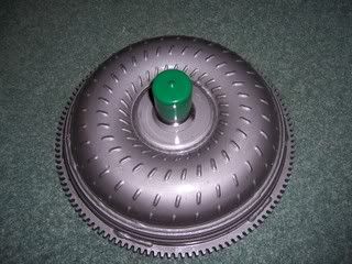

This arrived today:) Image Oh yes now time to assemble and drop this sucker in hopefully head is back tommorow.Oh and i'm 90% done painting the engine i'm gonna keep it a secret till its in the car.Hopefully it looks good i'll scrap the electric fuel pump for idea i'm gonna try and make this with as little headaches as possible for now I need a car gah.Total investment so far on the rebuild let's see roughly 200$ cam kit ,450$ (ouch) stall converter, engine 100$, Head shaving 80$ i believe, shift kit 20 something bucks can't remeber. and gaskets so not to bad i don't think considering I already had the intak/headers/carb takin care of already and random small parts previously purchased.So hopefully this baby runs well.
Kevin
