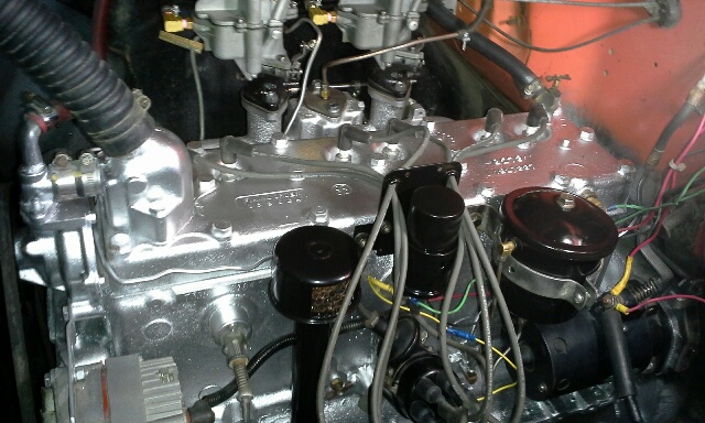

PostPosted: Fri Feb 16, 2018 7:01 pm
Posts: 107
Car Model: 1955 Dodge Truck

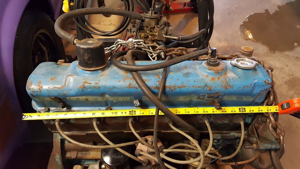

Do we get a vote?
I say keep the flathead.

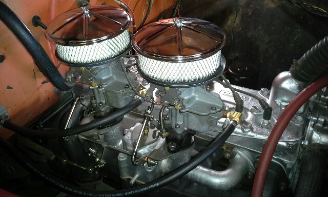

Sure why not, now I realize this is a Slant 6 forum, but hey the L head is it's Father, so to speak...
I could very well go and install a slant 6 into my 55, thats not a big deal, but should I is the question.
I do have a 265, to go in, my engine already has dual carbs and exhaust and if my pic files weren't so big would post some of them.

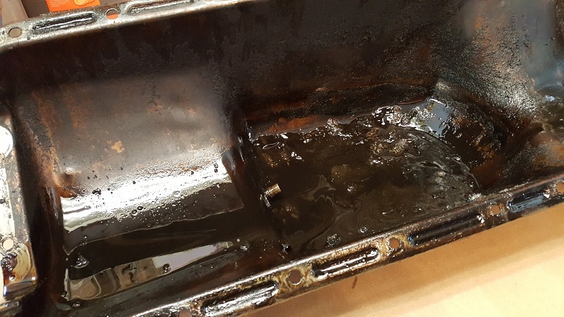

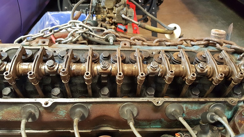

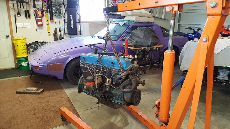

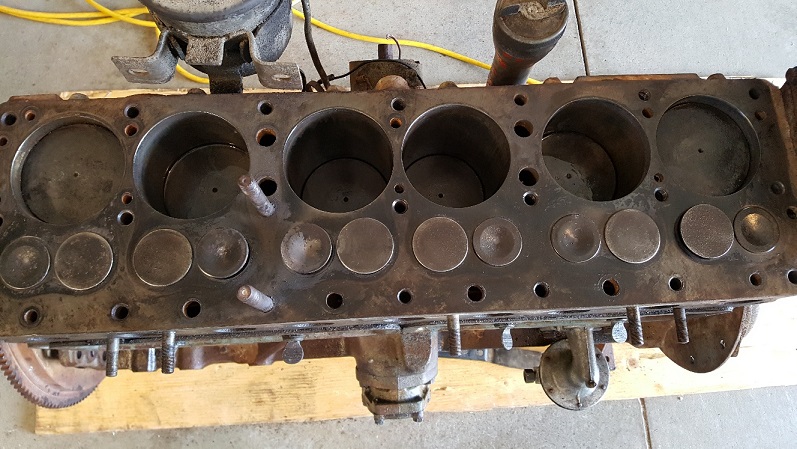

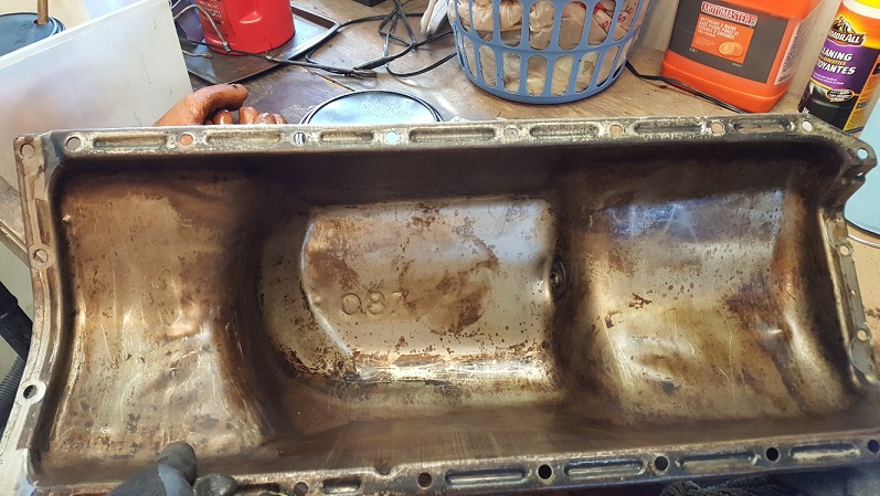

PostPosted: Fri Feb 16, 2018 7:15 pm
Posts: 107

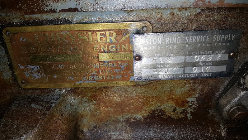

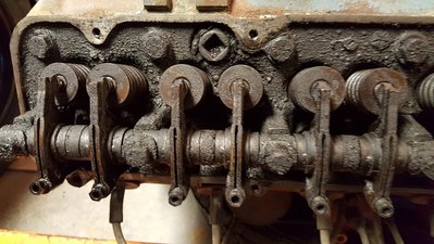

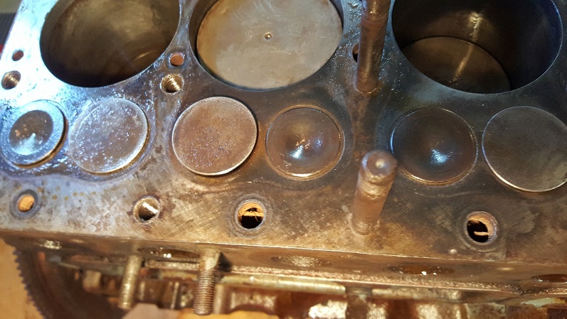

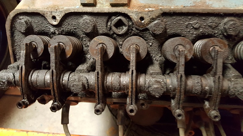

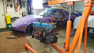

Some pics the 225, and the rockers and oil pan

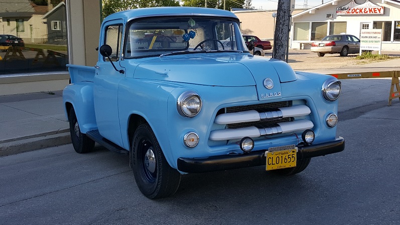

The 55 Fargo and the IND 265 Flattie

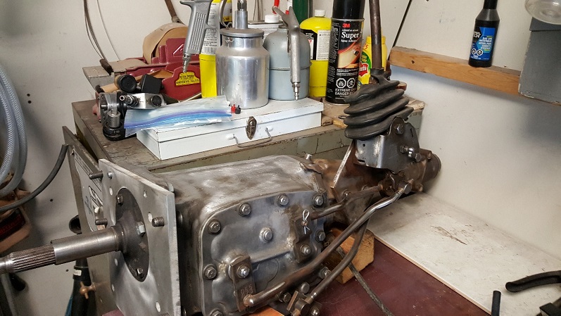

A few more pics, and my A 833 Overdrive from a 1977 Dodge Truck
George sells an adapter to install the 833 O/D with the flathead six. There aren't many 1955 Dodge/Fargo trucks left.

Oh im aware of the A833 plate
Tim Kingsbury and I are very well acquainted.
A lot of the A833 adapter plates have been sold.
I dont personally know whos already done the swap.
I just tentatively bought 2 IND 265s these might end up at Georges.
With 3.23 gears i dont really need an overdrive.
If i go the A833 route would switch to 3.73 gears or close.
