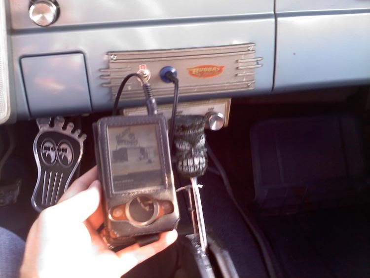

The plate solely acts as a device to fill the hole, turn the amp on and off and a spot I can plug my MP3 player into.
lindross
nice job! what is the mp3 hook up..brand and where did you get it?
Love the shifter,..what is that under the dash a CB?? cool 8)
The compartment resulting from the fresh air block off makes a nice resonance chamber which goes up the firewall, and thus, through the roof. This gives those little 4" speakers the illusion of being something much nicer. That coupled with a pair of 6x9 in the back makes for a nice sounding system
the fresh air door idea sounds great..people tend to forget about the resonance sound factor...(nerdy I know)...just cutting a hole in the door and putting a speaker in works but I find if you mess around a little,like putting a box behind the speaker or just some rubber sound material to line the door skin can make a big difference
What scares me most about installing a sterieo is the old wiring..I know some body has already stated this..(and yes Im to lazy to look up who did)..I guess I could put in a new fuse pannel...right after I finish the........ :lol: :lol:
On the side I'm a audio wholesaler. It's a headphone jack that feeds into the rca inputs of the amp. I can probably get ya just about anything ya need.

Some better pics.
The MP3 player I have (Zune) has a built in FM tuner so I have all my CD's, and FM radio ready to rock out the tunes.

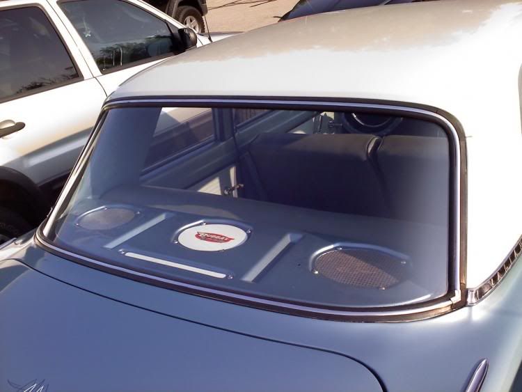

2 4" speakers hiddend in the factory location.
Car didn't come with the package tray so we did what we could to pretty it up without having ugly 6 x 9's above the deck and visible.
