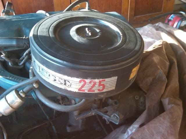

Here's a photo of the Charger air cleaner. From what I'm learning from Dan, this is looking like a 69 or 70 225 that could have come from a Charger.
The air cleaner is dusty/dirty but looks like it'll clean up nicely and the warning sticker is in good shape. The downside is that the "CHARGER 225" sticker is pretty faded, and the word "charger" is pretty worn. Somebody could probably REALLY take their time with a sharpie or something more professional and restore the parts of the word "charger" that are gone.
I thought I read somewhere the other day that they only made about 500 of the 68 Chargers with 225s in them. Too bad it's not a 68...it would be a rare engine.
As it is though, I don't think they made a ton of 69 Chargers with the slant. This engine has had a valve cover gasket leak, so there is a thin coat of oil on the block, but a gentle wipe of the finger exposes the shiny blue paint still present on the block, so I'm hoping it'll clean up nice for my install on Saturday.

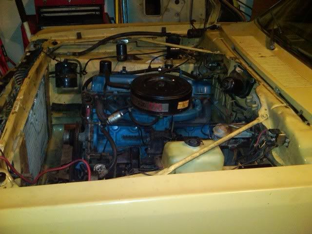

Started out this morning at 7am....and managed to pull the nasty SL6 in my Valiant, then degreased and pressure washed the engine bay and the 69 Charger SL6 that I'm swapping in. Got all that done by about 3pm.
Then installed the new engine...hooked up the transmission crossmember, exhaust, emergency brake, driveshaft and shift linkage.
Tomorrow I'll try to hook up the electricals and hoses, etc and try to fire her up!
So far, only a few bits were not direct swaps between the original 76 engine/trans and the 69 engine trans. First, the shift arm on the transmission is not the same on both cars (had to swap them out), second, the motor mounts are different (no prob....swapped them out too) and last...the 69 exhaust manifold has a deeper "skirt" (i think that's a good way to describe it) which makes the exhaust mount about an inch and a half lower. I kind of had to rig that for the short term, but I'll take it to an exhaust shop soon and have them shorten the pipe some.
Here's a shot from where I called it quits this evening.
That style of air cleaner assembly was used thru '69, not in '70, and the "Charger 225" just means it came out of a Dodge rather than a Plymouth (Plymouths from '62-'69 got an otherwise identical decal that said "Super 225"). It does not indicate what model car the engine came from, nor does it signify any particular or special version of the 225. The '69 air cleaner has a nipple on the underside of the baseplate, which is where the throttle plate anti-ice system draws its air supply. Cap this nipple securely if that system is not used.
No need. The "Charger 225" (and "Super 225") and air cleaner service instruction decals are all available new, in excellent quality and very inexpensively.
This part doesn't make sense. All slant-6 exhaust manifolds have the same "drop" dimension of the central collector. There have been reports of some slight angle differences of the outlet flange, but not of its height. The only such height difference is found between a 198 or a 225 and a 170, because the 170 block is ~1 inch shorter than the 198/225 block, so the head sits about an inch lower, so the exhaust manifold sits about an inch lower. But from your block casting numbers we had already determined your block is the high (198/225) item.

I've been working long days lately and usually have about an hour when I get home before I loose the sunlight, to work on the Valiant (in the driveway).
So...I've been pecking away at getting the new engine hooked up. And I've used the forum search engine a few times to verify that things were hooked up right.
This evening, I reached critical mass and poured a bit of gas down the carburetor and turned the key....and she came to life, and actually idled fairly well until the gas ran out.
At that point I lost my sunlight, so I called it a day. I'm working all day tomorrow, but I'll have some time on Sunday to get her running on a more permanent basis.
