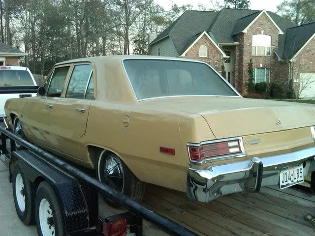

About a week ago I spotted what looked like a great deal on Craiglist and just couldn't pass it up. I've wanted a slant six car for some time and this seemed like the perfect opportunity.
The challenge with the car is that it hasn't run in many years. However, this kept it confined to a garage for more than 20 years and this also brought the sale price down to a few hundred dollars.
I'll use this thread to post some photos and track my progress in getting the old girl running again.
I'd appreciate any help that you slant six pros can offer.

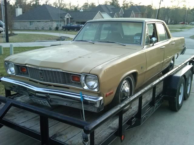

Below are a couple of photos from this afternoon when I got home with the car.
1954 Ford, Tudor Mainline
1976 Plymouth Valiant, 4 door

Beauty, eh! Looks like a really clean original base-model final-year Valiant. Congratulations on a terrific score!

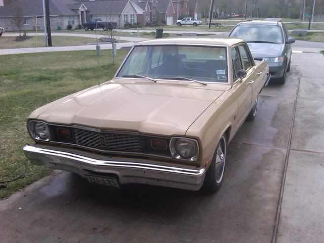

The Valiant continues to surprise me.
I gave her a good wash today and she shined right up...other than a few nicks in the paint, it looks almost new.

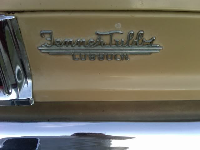

I noticed the Fenner Tubbs Co. on the paperwork. FYI, Fenner Tubbs ran a Chrysler/Plymouth dealership in Lubbock and did some racing on the side.
Cool...didn't know that about Fenner Tubbs.
That makes the dealer badge on the rear that much neater.
