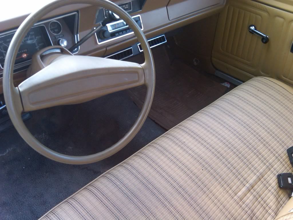

Here's a shot of the engine bay as it is currently configured...more work left to do.
Some interior shots.
I've had old cars in all sorts of conditions over the years, but out of the probably 20+ oldies, I've only had 3 with perfect or near perfect interiors. This is one of them. It's nice for a change.
Note the under-the-dash AC. I'm guessing this is a dealer installed thing....or did Plymouth put them in at the factory this way?
