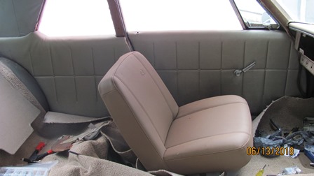

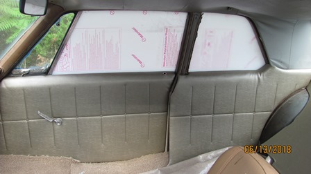

Progress of sorts. Interior instead of engine, but at this point I'll take what I can get.

Really nice! Looks roomy without all the “stuff”.

Yeah, I haven't really permanently installed the carpet and panels yet, or the seats. Just have to trim the carpet, put the door panel clips in and bolt the steering column in. I am anxious to finish and drive the thing.

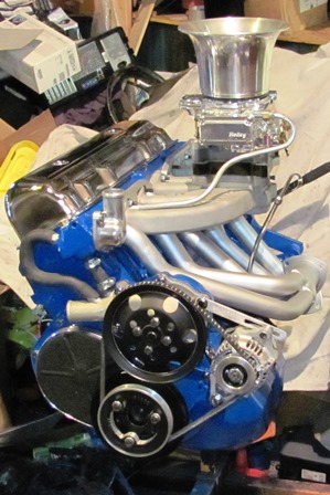

Let's see....3 years,3 ruined heads, 3 different camshafts, probably more.
I am hoping 3rd time is the charm.
Engine is (finally) sealed up and waiting to be dropped in. I may rig up a test stand to break it in first.
This goal has turned out to be almost as elusive as that aluminum head thingie.

Cool! Dang, screw the test stand. Bolt that sucker in and fire it up!

Nice work! If that engine runs half as good as it looks they’ll never catch you!

why the additional thermo bypass?
the head heater out to the water pump...
I am thinking you are just delaying warming up the block...
just buzzing coolant around the front of the head...

It isn't really a bypass hose. It is actually a heater bypass. I have had bad experiences with those rubber hose caps rupturing. The aluminum water pump outlet seemed a little thin to tap for a plug. I figure with this setup, I can easily swap out the water pump without worrying about capping the heater fitting. This is simple and effective, requiring no mods and I don't worry if the thing will burst on me. The hose is a DayCo 87617. It is preformed and looks like it was made for this application.
