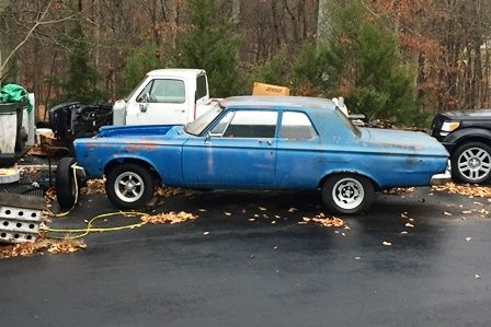

yes, I still have the 65 Belvedere I, and I am still building a racing slant six for it. After the head porting fiasco this year, I am taking it nice and slow with the (third) head. Short block is ready and waiting, same for the A904 trans. Rear suspension is ready to go. I am currently getting new bushings for the front suspension.
Here is the car waiting to swap places with a 72 Cuda in my shop. Body and paint wise, it looks like crap. I am getting a pair of rear quarter panels for it but I am not doing ANY body work/paint until I get some miles on this thing (a 1/4 mile at a time).

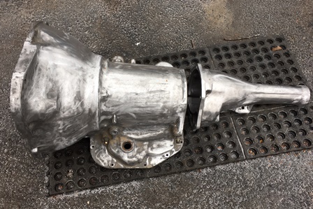

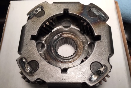

Minor setback with the transmission. One of the gears in the rear planetary apparently has been binding. You can tell which one in the picture, as that corner has turned blue from the heat. I did manage to get it freed up, but it now has a lot of play in it. It would probably work, but it is a lot noisier than the other three. Just to be safe, I ordered a replacement planetary set. I have enough other things to work on until the new gears arrive.
PostPosted: Sun Apr 01, 2018 4:07 am
Posts: 17690
Yes, definitely replace... Keep turnin' those wrenches!

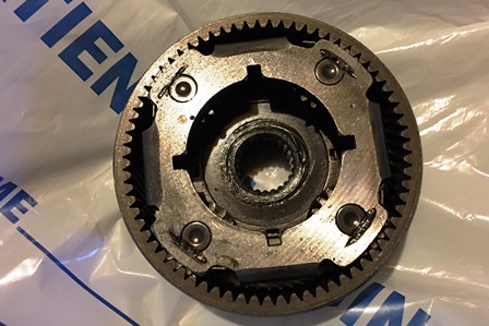

OK, now this part looks a LOT better.

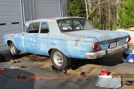

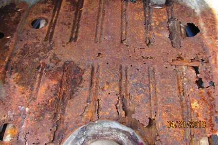

OK, moved the car over to the shop. Vacuumed the inside and trunk. Found some bad news in the trunk. Water leaked in and ruined what was left of the floor. Looks like I am giving AMD a call. The good news is that the interior floor, although also rusty, is solid enough for now. Just carpet and bolt the seats in.

Cut the floor out and weld in some braces for a fuel cell and rivet in a flat alum floor. You can run it like it is for M-D in a month. Just don't pop the trunk in tech...
PostPosted: Sun Apr 22, 2018 6:13 am
Posts: 1482
I ordered the new AMD trunk floor (dang thing costs as much as the interior floor-oof!). It really shouldn't be too difficult to install. I was worried about tech, especially with the battery back there. So rather than chance it, I am replacing it. I need to find some sheet aluminum to place where the rear seat used to be. I am really hoping to get enough done to race it at Mason-Dixon in May. It won't be pretty and might have some duct tape here and there holding it together, but the plan is still M-D in May.
