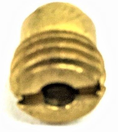

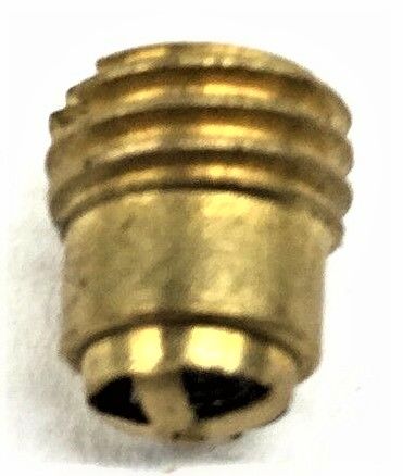

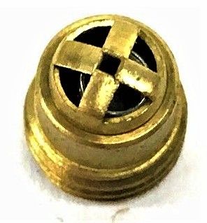

Image This is older carter with small holes top to bottom

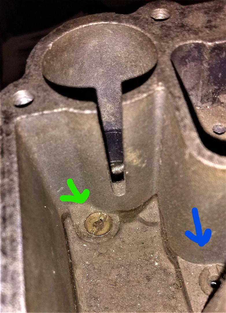

Green is pump check ball part number 122 - 108 s blue is the main jet , that's what it would have looked like in 1972. Sometime after that check ball was eliminated and accelerator pump Filled from the top, curious if yours looks like that.

matv91- Yep, my accelerator pump well has the check ball. Has "Carter" cast into the side, no signs of "Weber". I think it is a fairly old piece. Interesting that it is called out as a carb for a 383. The emulsion tubes on the venturis only have one big hole on the bottom. I should have taken some pictures while I had it apart. If I take it apart again I will take pictures.
