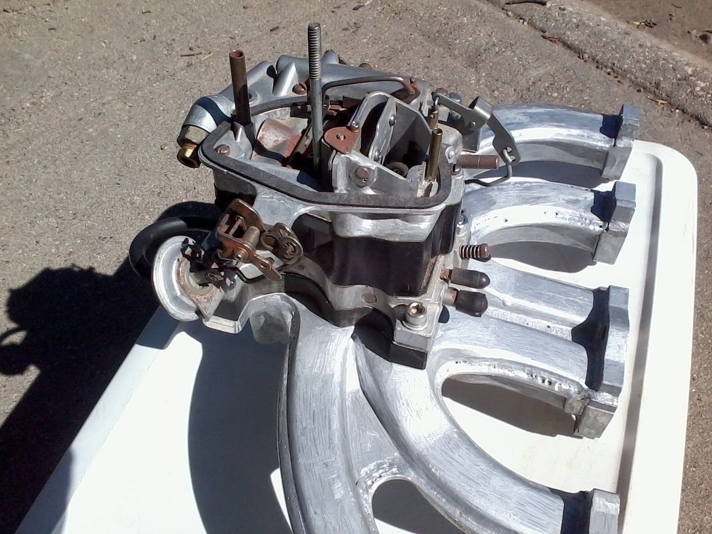

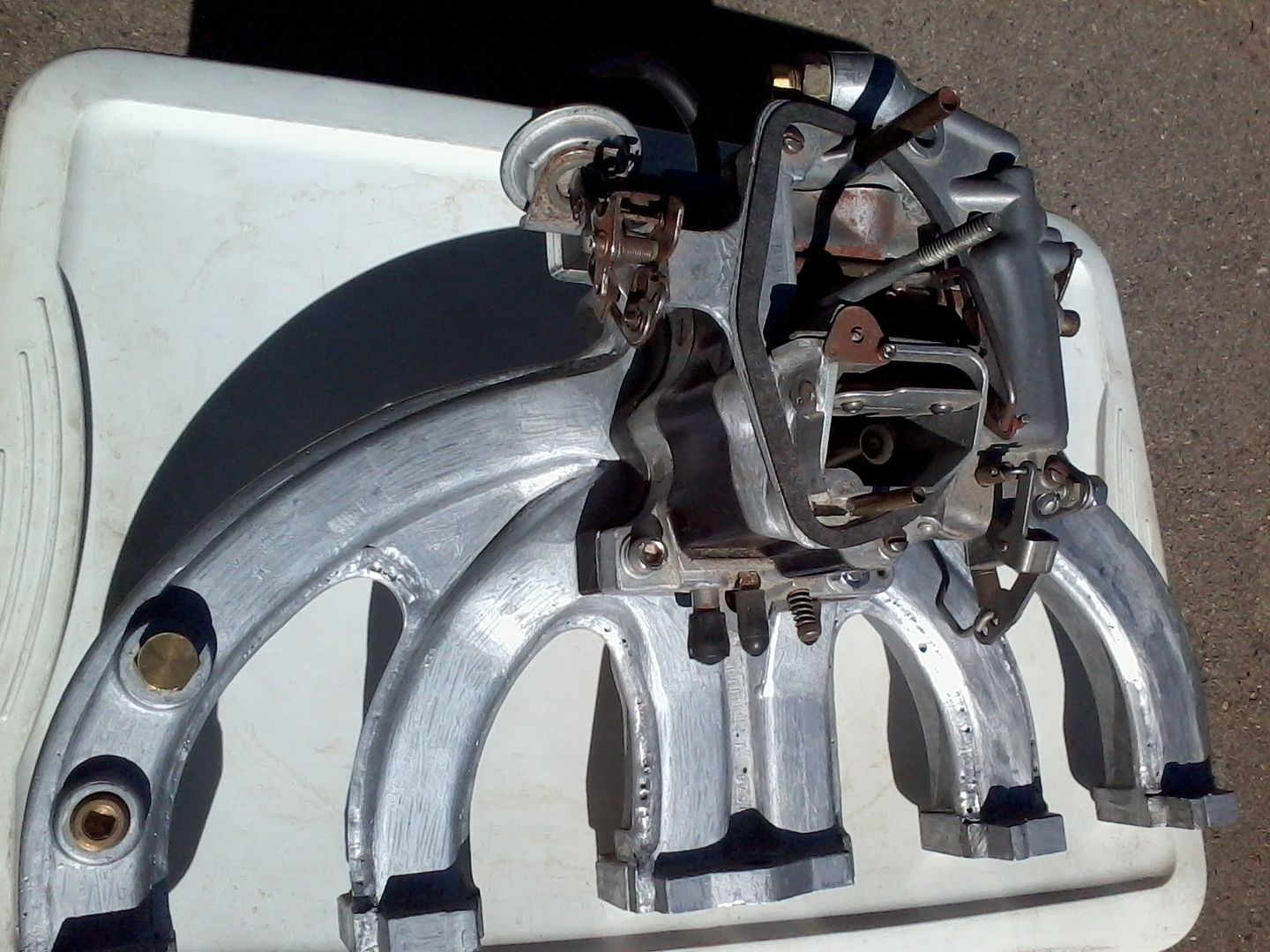

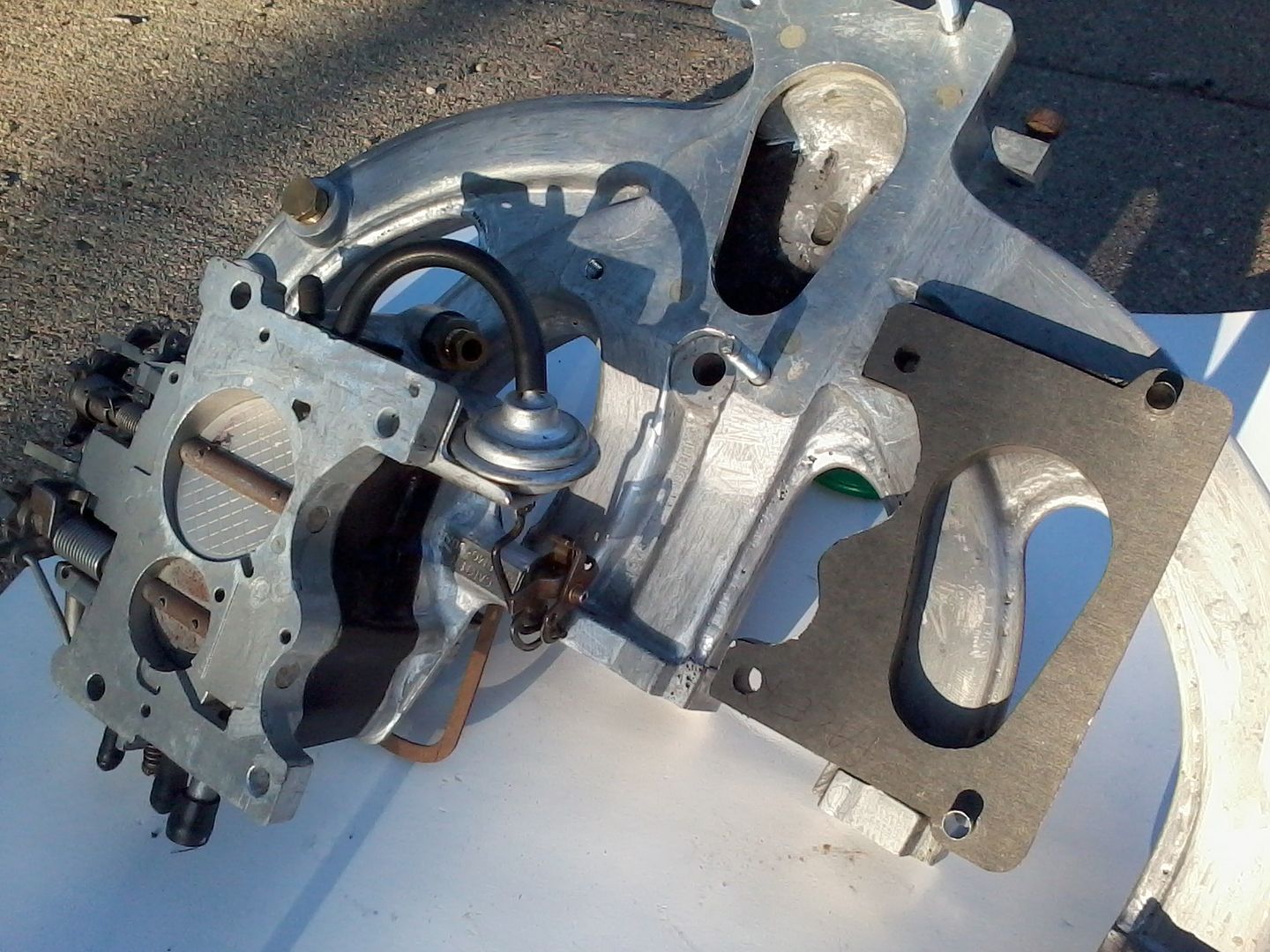

From your friendly "Precision Hacksaw Machinist" - I spent years learning a lot about carburetion, trying to get a Four-Barrel carb to run right on my 225 Slant Six. I learned it was just too over-carbureted, too many CFM, not enough cubes. So I decided to make my own progressive Two-Barrel carb.
I figured an 850-cfm Carter Thermo-Quad ran a 440 so well, half of one should run a 225 pretty good. So I took a non-smogger and cut it in half! Countless man-hours and some J-B Weld later, ta-da! My one-of-a-kind 300-cfm Carter Thermo-Dual and intake manifold to match.
It's amazing what you can accomplish with a hacksaw and a file. This was all done by hand, nothing was 'machined'. How's that for home-fabricated?

You really need to post a how-to, with many more pics. A description of cut line locations would be highly beneficial, too.

Cool idea. It's nice that the Carter has the float chambers on the sides rather than the front and back like a Holley. My question is, how does it run? Any before and after testing?

TQ's aren't as compatible with the available tuning parts for the AFB/AVS, some things will work but you may need to scavenge parts from small block TQ's to get a bit closer to what is needed.
Two things I'd be worried about:
1) Even 30 years ago, TQ's were notorious for having the phenolic resin bowl warp and leak, you may have a good donor now, but it's only a matter of time...
2) Small plenum manifolds with the big secondary aren't very well matched, typically this creates low vacc. signal once the secondary
cracks a bit (it doesn't take much opening angle on the larger plate to flow the same as the smaller plate at less of an angle). Quick drop off of vacc. is usually accompanied by poor gas mileage (think large Holley 2 barrel on not so gasket matched super six manifold...)
It is a nifty idea that one carb manufacturer has put into play, but with nominal bore sizes...I think using one of the 340/360 TQ's would have been better start.
Let us know how testing goes.
