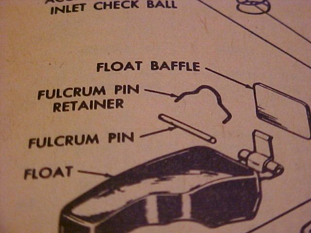

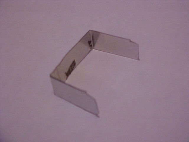

Have figured out a Fulcrum Pin Retainer that is a quantum improvement over the ORIGINAL Fulcrum Pin Retainer.
It's simpler, easy to make, will do the same thing that the ORIGINAL Fulcrum Pin Retainer did without a lot of the fuss of installation and removal.
Will have JPGs of the ORIGINAL Fulcrum Pin Retainer from a exploded drawing of the Bendix Stromberg Carburetor, and then JPGs of the actual, fabricated Fulcrum Pin Retainer.

Here is the NEW Fulcrum Pin Retainer.
This first JPG shows the drawing of the Fulcrum Pin Retainer:
This next JPG is of the NEW Fulcrum Pin Retainer:

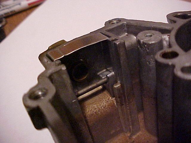

This next JPG is another view of the NEW Fulcrum Pin Retainer holding the Fulcrum Pin in place.
The Air Horn which goes on top of the Stromberg Carburetor Body holds the NEW Fulcrum Pin Retainer in place.
