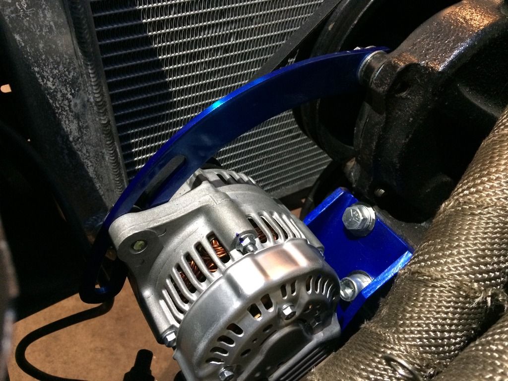

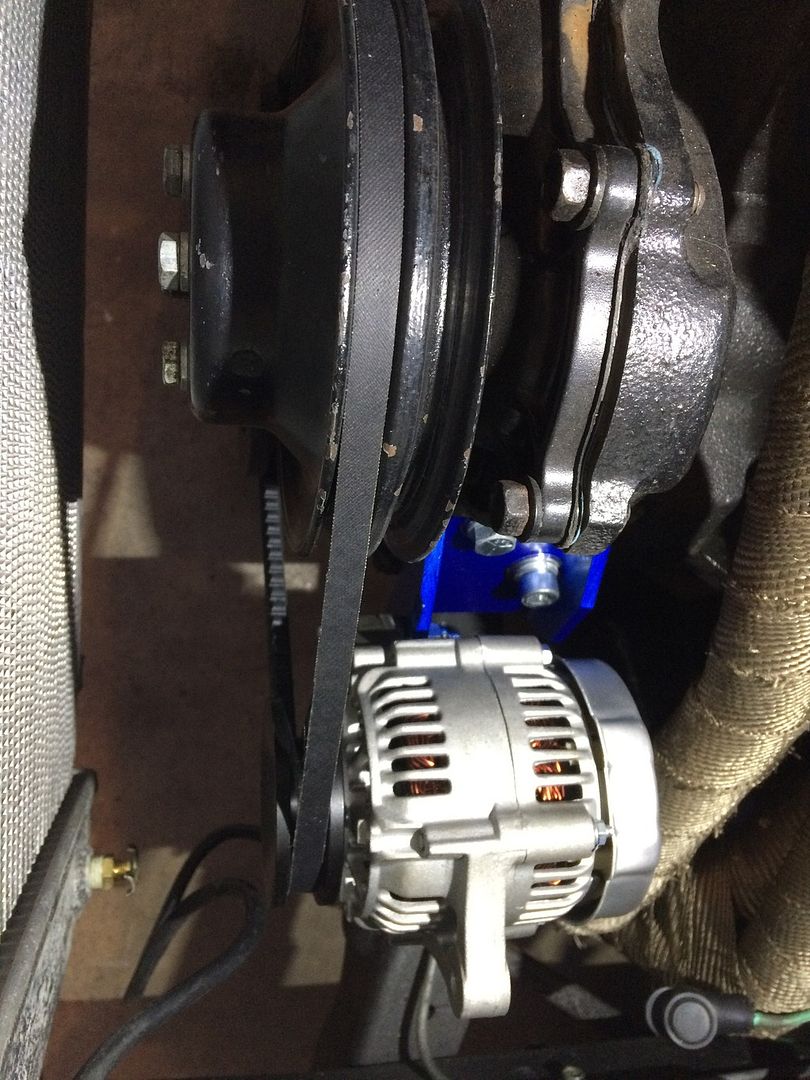

I got a new mini alternator for my car and here are a few pics of the install.

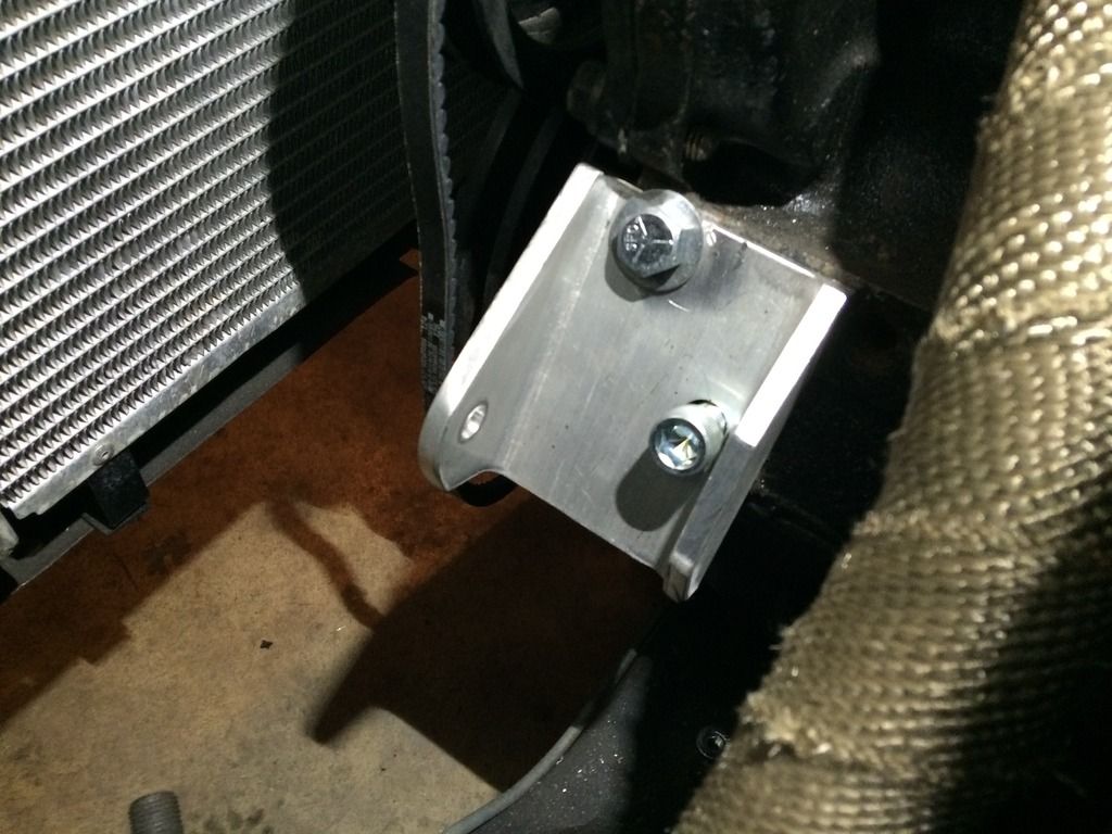

First I took a piece of heavy duty Aluminum channel and cut it down and bolted it to the block. It needed to be as far forward as it it could be to get the pulley to line up, so I used a Allen head bolt in the back hole.

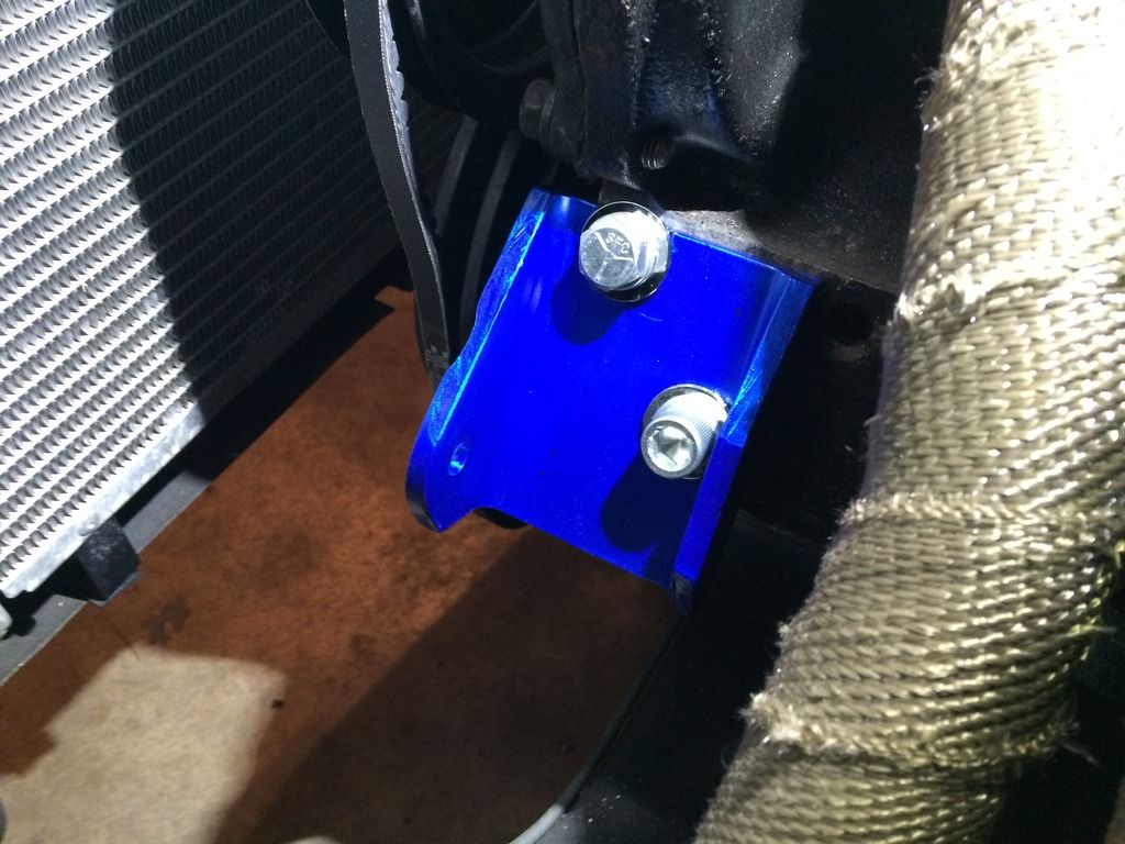

A little bit of the blue anodized paint
Mounted to the engine and everthing lines up
Small block chevy upper bracket cut down a bit and the the install is complete. The alternator is about 1" from the front header tube, but after running it for 20 minutes it was still just warm to the touch.
