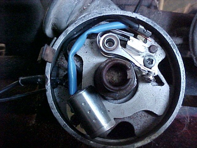

Here are the JPGs of Lorrie's Distributor and the See-Through/Cut-Away Distributor Cap:
This first JPG is of the innards of the Distributor. The Rub Block is precisely on the peak of the Number One Cylinder's Distributor Cam Lobe. The Points are open .020". The Engine is at Cylinder Number One's TDC:

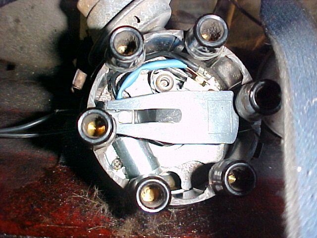

This next JPG is looking down through the top of the See-Through/Cut-Away Distributor Cap. Again, the Rub Block is precisely on the Peak of the Number One Cylinder's Distributor Cam Lobe. The Points are open .020". The Engine is at Cylinder Number One's TDC:
Notice that the Rotor's trailing edge is all but TOTALLY past the Distributor's Number One Spark Plug Contact Terminal. This setting is TERRIBLY retarded. The Rotor should be exactly in this position on the OTHER side of the Distributor's Number One Spark Plug Contact Terminal.
Don't know HOW this happened.
Have thought that it might be because of the Cam/Distributor Gear interstice.
Have thought that it might be because of the Timing Chain having either stretched or jumped a cog, but can't see how THAT would have happened.
Nonetheless, this is how Lorrie is at the immediate present.
QUESTION: Would it be a wise move at this point to loosen the Bolt holding Lorrie's Distributor in place and rotate it CLOCKWISE till the Number One Cylinder's Spark Plug Contact Terminal is on the other side of the Rotor Contact Point?

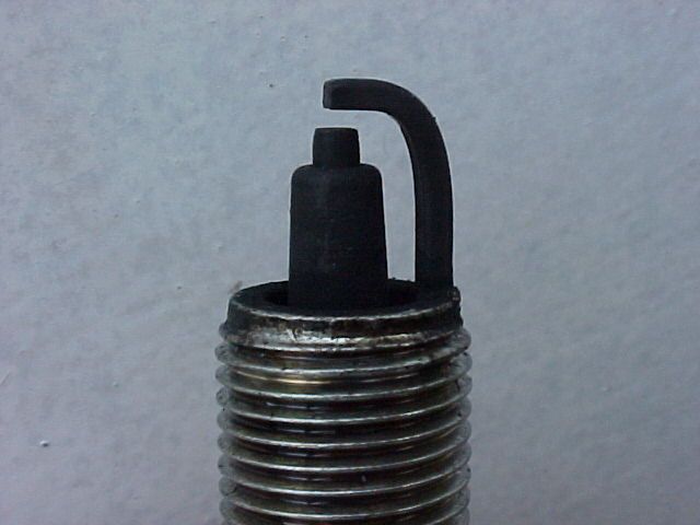

This last JPG is of one of Lorrie's NGK ZFR5N Spark Plugs.
The next thing is to clean all six of Lorrie's Spark Plugs and reset the Gap. Then am going to turn the Idle Screw in a half a turn and take it from there.

No, don't rotate the housing, as that would mess up your timing.
Also, when the advance start working, it will be closer to the post, than it is now.
It has to be on one side (but not too much obviously) to allow it to stay in the right area when the advance mechanism(s) do their things.
If you really want to align the cap to the rotor, I think it would be better to modify the little tab that locate the cap, IIrc, it is in the same part that has the "hook" that hold the cap on.
Hey Mr. RC,
Was thinking that the timing was already messed up. Was thinking that advancing the timing might be what Lorrie needs to start and run.
Thought of THAT too. That's why I haven't done anything to the Distributor. Didn't want to do something and mess it up.
Can see what you mean.
Know what you mean. But no, am not going to modify the cap.
So if the timing is NOT retarded, and the Bendix Stromberg Carburetor is putting out too much fuel instead of not enough fuel, then where do we go from here?

I think you should check ignition timing, if you have any doubt about it.
I don't want you to modify your cap, but if you want to get the rotor to point somewhere else than it does, you move the clamp-hook thingies on the distributor body.
But I doubt you would need to do that.
I have had slants start with ignition timing WAY off (16degrees AFTER tdc) but I think that setting it right is the first step, before doing anything else.
I guess that (in a "van") you could reach the starter button, and the distributor at the same time?
Just push the button, and play with the distributor timing, and see if it makes any poofs, or bangs (or starts)

When the rubing block on the points is at the highest, that is where the points are open the max. If you put a test light on the points the rotor will be much closer to the tower position as the points just open.
Richard
Yes The fire BEGINS when the points FIRST start to open which will be WAY before the points get to the 'top' of the peak. I would say by looking that the timing is ok...

When the rubbing block on the points is at the highest, that is where the points are open the max. If you put a test light on the points the rotor will be much closer to the tower position as the points just open. Richard
Hey Richard,
Alright. Have finally come to THAT realization.

No, no, no... The NGK ZFR5Ns gapped to .035 were installed just a short while ago at SSD's behest. They are installed without the Washers.
that being said I would just replace them and try that.
They come in boxes of four. Got two boxes. Have two of them left over. Will have to get another box of them from NAPA. Will do that on Monday. They will be here on Monday evening. Will install them on Tuesday morning if what is done today doesn't get Lorrie up and running. But have a feeling that we're going to find what it wrong today when the Ignition System is given a diagnostic with a Test Light.

Lorrie is all set up to see if her mighty 225 Slant Six Engine will start and run this morning.
The NKG ZFR5N Spark Plugs have been cleaned, the gap set, and the Plugs installed.
If she starts and runs, then will see if she will rev up. If she does, will take her for a test drive. If she does alright, will install the Floor, and the Engine Cabinetry, and take her to be inspected.
If she doesn't start and run, will run the whole set of diagnostic tests to hopefully find out why she won't.
Will keep you all updated.
JC
