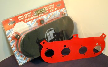

For air cleaner you'd have some options. You could use one long air cleaner (something like this but with one more carb spot http://www.rdent.com/images/itg.jpg ), one aircleaner for each carb (like this, this is a hemi 6 Charger E49 engine http://www.chargerclubofwa.asn.au/Visit ... zrts02.jpg ) or use the foam socks and put one on each trumpet (so six of these http://www.bavauto.com/assets/product_i ... t/u400.jpg ).
