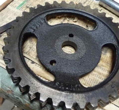

Add cam sprocket oil passage
Oil bleeds-out of the front cam bearing and builds some pressure behind the top timing sprocket.
Drill a small hole from the inner edge of the "cup", on the back of the sprocket, to the front face of the sprocket.
This directs some of that oil out to the front of the sprocket where it can be thrown around. Doing this also reduces the chance that pressure behind the top sprocket will push the sprocket / cam assembly forward.
Some top sprockets already have this feature but add it if a passage is not there.
Basically, this is just another way to get more oil onto the sprocket teeth and chain.
Original post has a nice photo. What is not addressed: Drill straight through? At an angle?

Figured this one out myself later in the day:
The worn part in the van has a 1/4" hole drilled at approximately a 45° angle:
I realized that the big locator slot in many of the new cam sprockets including the one i have serves the same function of letting oil flow, so for me no drilling needed.
Still wondering how the front crankshaft oil seal can cut grooves in the vibration damper and whether adding an oil slinger might exacerbate that. And whether Chrysler designed sufficient oil flow for the timing set or whether DD’s oil gallery hole drilling is needed/advisable.
