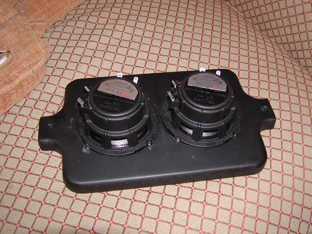

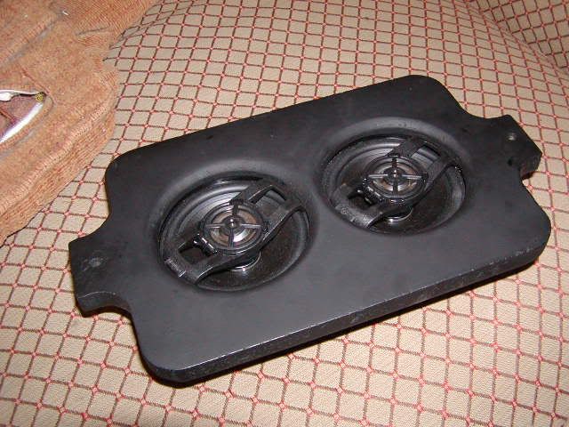

I made a mount to put 2-4" speakers where the origional 4x10 speaker used to be. These MB Quart speakers have a crossover that will need to mounted. I made the speaker mount out of particle board but I was thinking that I might remake it in some type of plastic, it would probabily last longer.
I could make a speaker box instead of a pannel, it would be a tight fit very hard to install but it would fit.

Nice!

Very nice work. I've always wanted a two channel dash speaker setup. Making a box that will clear the heater controls will be a challenge. Just a fyi, but the original speaker should have been a 6" x9". Originally they used a funky bracket to mount the speaker to the dash. The bracket was stamped steel had 4 holes for the speaker and two to mount to the dash. It spaced the speaker down about 3/8".

I have taken a few 66 dashes apart but haven't had one with a speaker in it just assumed it was a 4x10 like so many old cars. woops.
I could easily make a box to fit over the heater controls, the close part is the part of the dash just above the heater controls. If the speakers were spaced back a bit that would solve the fit problem....I'll make one to see how it looks/fits.... it shouldnt take to long
