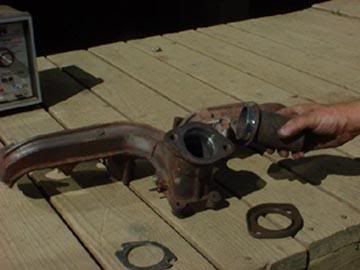

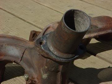

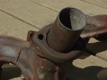

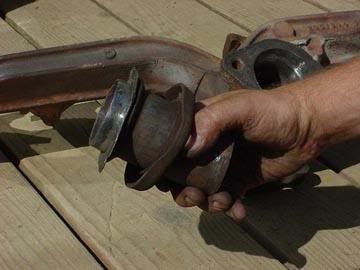

From skidderdriver:
After cleaning up a stock manifold and grinding it out to 2 1/4"(to go with my super 6 intake),I wanted a way to attach a head pipe stub.As I dont have access to a welder till logging season starts ,I figured out something different.I cut a 2 1/4" headpipe off of one side of my old F250/390.It has a lip and donut style seal to the manifold so I pulled the donut off and ground out my manifold till it slid in to the lip.The lip now sits on the gasket with the retaining ring clamp bolted over it.There are 4 photos here.
Im going to use mandrel bent 45s and stainless band clamps to take the exhaust under the car and back to the muffler.
