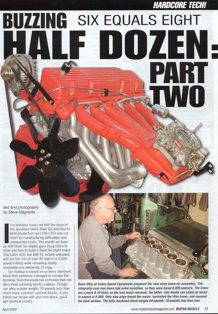

Let me re-phrase, the 198 has the tube type heads. Building a 198 never crossed my mine, but I could use the rods from it for a "Long Rod" engine. If it is a 225 I will go with that.
What am I looking for? Well something simular to this: http://www.slantsix.org/articles/hrm-sl ... 03-pg1.jpg
It will be a daily driver looking at around 300 miles/wk. Dan, more then likely I'll never make it to the speedway no more then once a year. My plan is to build an engine that's got plenty of UMPH! In translation good low end to mid range torque. I hope this helps.

Article you referenced is generally not at all compatible with your street/mileage/low-end torque goals.
Try a 2bbl "Super Six" setup, Dutra Duals, and also work closely with Doug Dutra (Doctor Dodge on here) to get your compression ratio, ignition curve and cam specs/selection dialled in.
