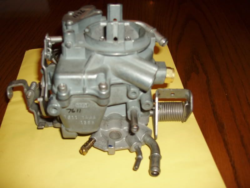

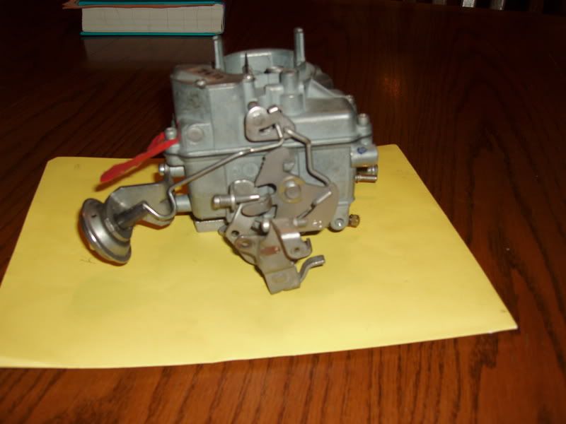

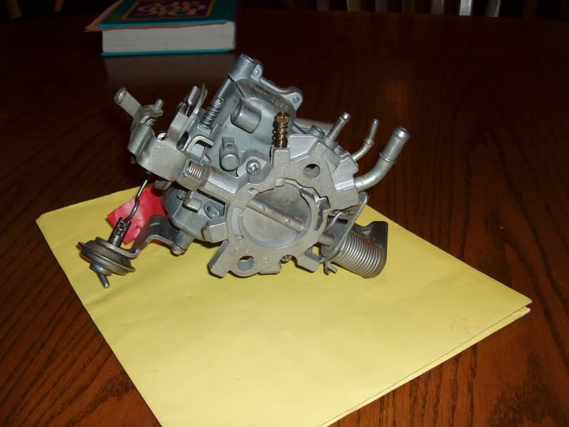

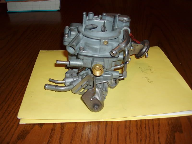

This is the carb My question is what do I need to hook up on a 73 slant the carb is a 75 also how does the kick down linkage connect

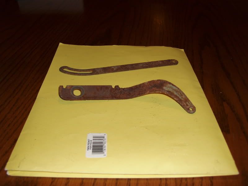

Here is the linkage that I got form a Volare at the junk yard will this work with this carb? I still think I need more linkage to connect to the kick down rod from the tranny.

Somebody correct me, but the Volare gave you a kickdown throttle link and throttle spring retainer for a 2 barrel super six setup....
The 1975 setup doesn't require a throttle return spring as the Holley 1945 already has one integral to the carb (and the 1973 Holley 1920 also).
The kickdown link basically is an adjustable rod that connects on the lowest hole on the throttle lever, the cable hooks to a hole higher on the lever (using a 'peg' with a cotter pin/'hairpin').
Technically no, it doesn't require one to operate, but for safety reasons, it's /highly/ recommended.

Any suggestions as to what ports/ hoses should be hooked up on this carb I am running a Ford carb now so I can not just plug in the hoses also any suggestions on where I can locate the kick down rod. i posted in the parts wanted forum. Jim

PostPosted: Fri Nov 03, 2006 8:16 pm
Joined: Tue Aug 17, 2004 4:53 pm
Posts: 194
Location: Kansas
See if this helps.
82 D150 Slant6 Shorty
http://www.cardomain.com/ride/658846
PostPosted: Sat Nov 04, 2006 4:13 am
Joined: Tue Sep 12, 2006 5:10 pm
Posts: 212
Location: Horseheads NY
See if this helps.
Thanks that is exactly what I was looking for !!
