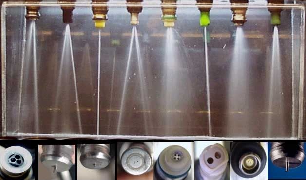

I found this picture on one of my many trips through the internet and thought I would share it with you.
Anyone have thoughts or reasons why one style is better than the other?

Hmm. I think the second from the right and the fourth from the right would be the best injectors to use. Looks like they do a better job of "misting" the gas.
Any chance you found out what brand those were?

The injectors that have a pair of holes or two groups of holes are used on engines with 2 intake valves to put a stream down each intake port.
3rd from left and 3rd from right look like they have a problem. I wonder if the test pressure may be too low.
No, I too wish they had listed the type of injector on the bottom of the pics.
I suppose I should credit the site I borrowed it from shouldn't I? www.not2fast.com
