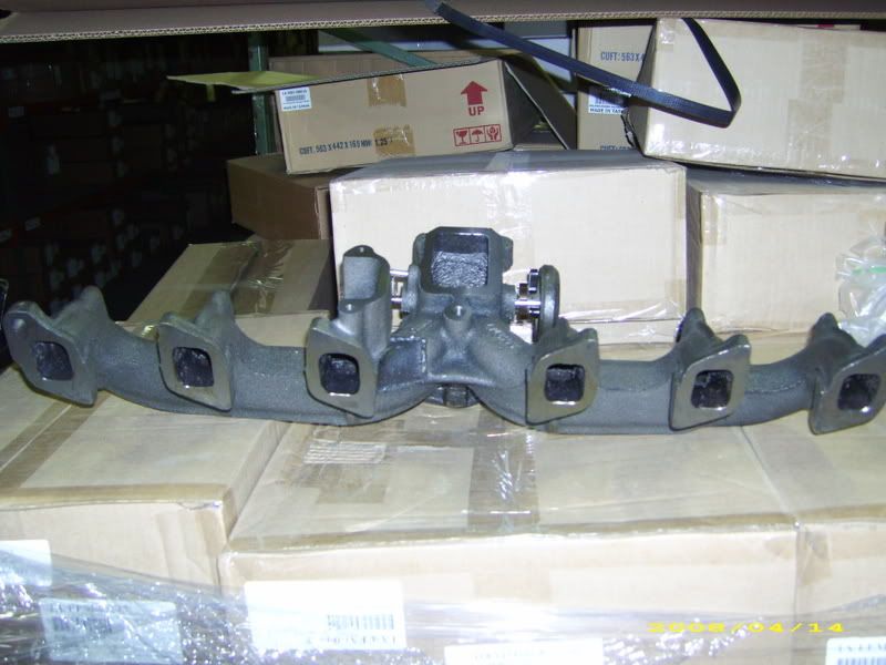

I was wondering if anybody has experiance with this exhaust manifold?
As you will see, I haven't had much luck this weekend.
http://www.1aauto.com/1A/ExhaustManifol ... 009/568470
They took a picture of port side. Only thing missing is stid to center intake manifold.
Jim

Thanks sb, can you tell me if the center hole is threaded to accept the bolt for manifild?
Is ribbing thicker. I may want to smooth out the exhaust ports. is there enough meat to do so?
Thanks again.
Jim

I have one of these manifolds on my Dart. It does have the correct threads and a bit more rib than a stock manifold. The bad news is that the casting quality was not up to late '70s Chrysler quality control standards - there was casting flash and huge parting lines everywhere, including places that shouldn't have parting lines. I've heard of a few that had a port blocked with casting flash and had to clean it out. It's a pretty close copy of stock manifold off a later version with the feedback carburetor so wall thicknesses are the same.
One other note: 1A Auto checks to be sure the parts fit the vehicle listed. While normally this would be good customer service, they don't quite realize that this manifold fits a lot more applications than the ones they listed.
