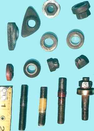

what are the conical washers
1972 Plymouth Duster 225 Super Six Slant
PostPosted: Mon Apr 28, 2008 1:32 pm
Posts: 4880
The conical washers are round, concaved on one side, convex on the other.
These are the ones in the middle, left of this photo, just above the tape measure.

what are the ones with the nut heads wiht washer bodies for?
PostPosted: Mon Apr 28, 2008 9:41 pm
Joined: Mon Nov 05, 2007 1:48 pm
Posts: 351
Location: PDX, OR
the one on the bottom right? just looks like a stud wit a conical washer and a nut on the end. or the washer wit the nut on it, that one ive never seen on a slant

yeah me either
