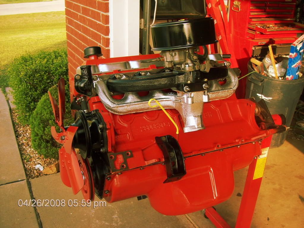

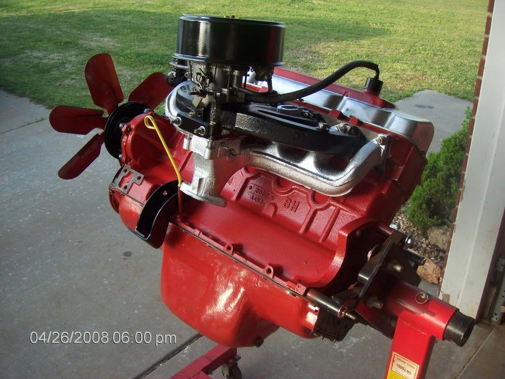

I completed my first slant six it has:
8.4 compression ratio .060 of the head
3.460 bore
198 crank and rods
stock pistons with cast rings
Stock cam bumped up to a true .44 intake lift at valve degreed and set 3 degrees retared
stock valves with hardened exhast seats
ported intake and exhast runners
super six intake and exhast gasket mached to head
Carter bbd from a v-8 pre emmissions stuff
Stock timming chain
All for a total of
$275 machining, piston pressing, valve job and mill
$280 Engine rebuild kit with piston and oil pump
$40 Cam regrind
$55 supplies (silicone, paint, ect.)
_____
$650 give or take $20
Not bad for a fresh engine.
Here are some before and after pictures :D
http://i263.photobucket.com/albums/ii13 ... -07020.jpg
http://i263.photobucket.com/albums/ii13 ... IM1978.jpg
http://i263.photobucket.com/albums/ii13 ... IM1977.jpg
http://i263.photobucket.com/albums/ii13 ... IM1973.jpg
http://i263.photobucket.com/albums/ii13 ... IM1974.jpg
1964 barracuda 198 slant

Nice looking motor! :D
I like that valve cover treatment. :D :D

Looks great!
You may want to re-think that big steel fan, those "eat" a bit of power and make a bunch of noise. My car actual cooled better at freeway speeds with a smaller fan.

two tone valve cover looks cool, nice job, what is it going in?

Looks great!
One thing - do you mean the cam is 3 deg retarded from the stock spec?

I split the overlap and retarded it three degrees from there to hopefully gain a litle higher end performance. I'm not sure being that it is a small overlap if it will make a bunch of diffrence. I'm just playing with what I have to make the best of it with out laying out the cash for a hi-porformance cam. I also may put automatic in it later if my wife gets tired of driving a stick.
