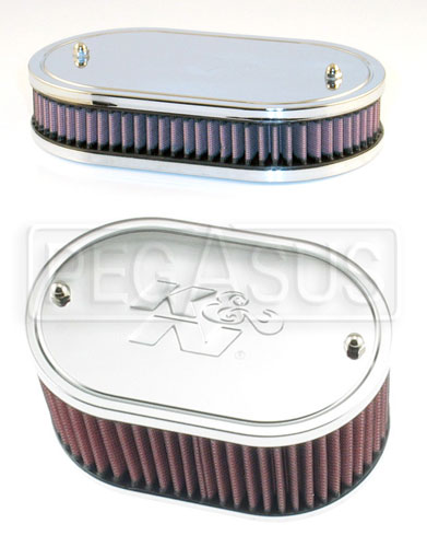

Also, K&N makes an attractive and quality air cleaner for all 32/36 Weber carbs. Pictured below:
Direct link:
http://www.pegasusautoracing.com/produc ... oduct=3812
Note that the Weber 32/36 plus a half inch tall adapter will really raise the height of the carb configuration. Pegasus Racing offers two different heights. Obviously Jeep set-ups can handle the 3.25 inch tall air filter but a stock Dart hood might do better with the shorter 1.75 inch version. It is part number 3812-1.75. It is $59.99 but the cheaper cotton filter Weber sales is around $25.00 to $30.00. I think the extra money is worth it for a K&N filter. Just my opinion.
