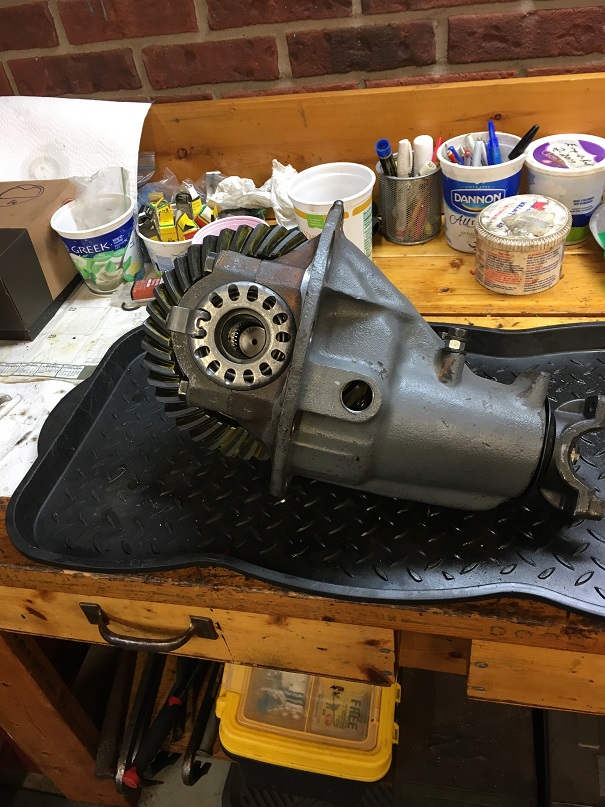

Posts: 3857
pulled the ring gear to check pinion bearing loading,
it was turning at 2.5 inch / lbs with the seal installed, that is fine

the 'chunk' is back together
concerning the whine on deceleration, I also checked ring and pinion backlash prior to dis assembly.
the spec for a new gear set is .006 to .008 backlash,, I found .017 ,,, double the backlash specification,
as the gear set I am using is used, I believe it is the original to the 742 case it certainly did not wear in to cause the excessive backlash, possibly I did not have enough pre load on the carrier bearings and the carrier just shifted a bit, or I just missed the set up during assembly.
To eliminate one root cause, I spent a lot of time making sure the side adjustors moved freely in the housing caps, cleaned up a few thread burrs ,,,The side adjustors run in easier now that they did before.
I was really careful this time, I set the back last at .010, that is on the high side of the tolerance but I believe that is fine with a used gear set.
