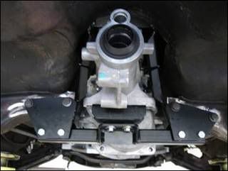

I modified the stock crossmenber and merged it with the Mustang system. Essentially I am using the exhaust hanger from the Mustang system to connect to the Valaint stuff. You can see mine is on an angle....
Imageclick to view full-version
The crossmember is the hardest part of the swap.....

The trans mount is similar if not identical....
You could nevver get a T5 under a 3spd floor.....an RAP just fits.
I never welded any of this....I bolted everything together ......took it to the shop for a quick zap. All that is welded is the one bolt on the left side.
Lotsa grinding though.
I stuffed the crossmember full of rubber mount so the trans sits on it....
The trans bolts to the 2 big holes in the mount.....
Check the snow in the pic......

The BHs from the group buy have the 5 deg lean toward the driver, so the mount needs that as well.
Let me see if I can post a pic...
