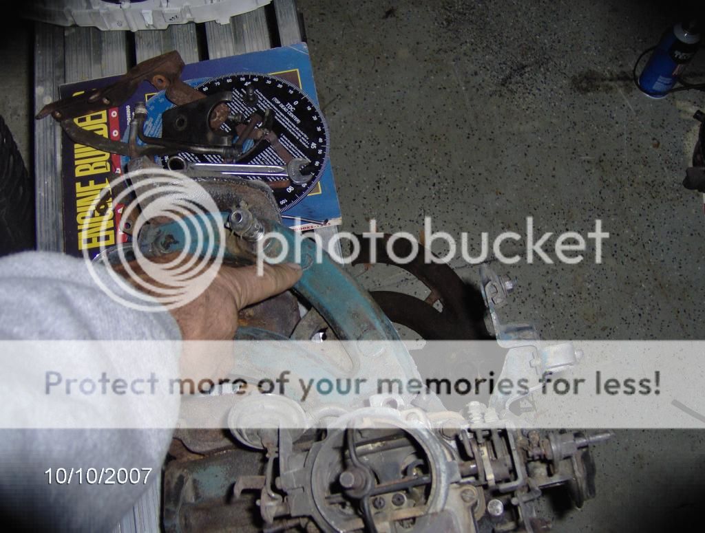

Another question, I picked up a spare set-up yesterday locally and am wondering why this intake does not have the cut-out for the sensor that my other cast iron super six intake has ( down on the floor below )

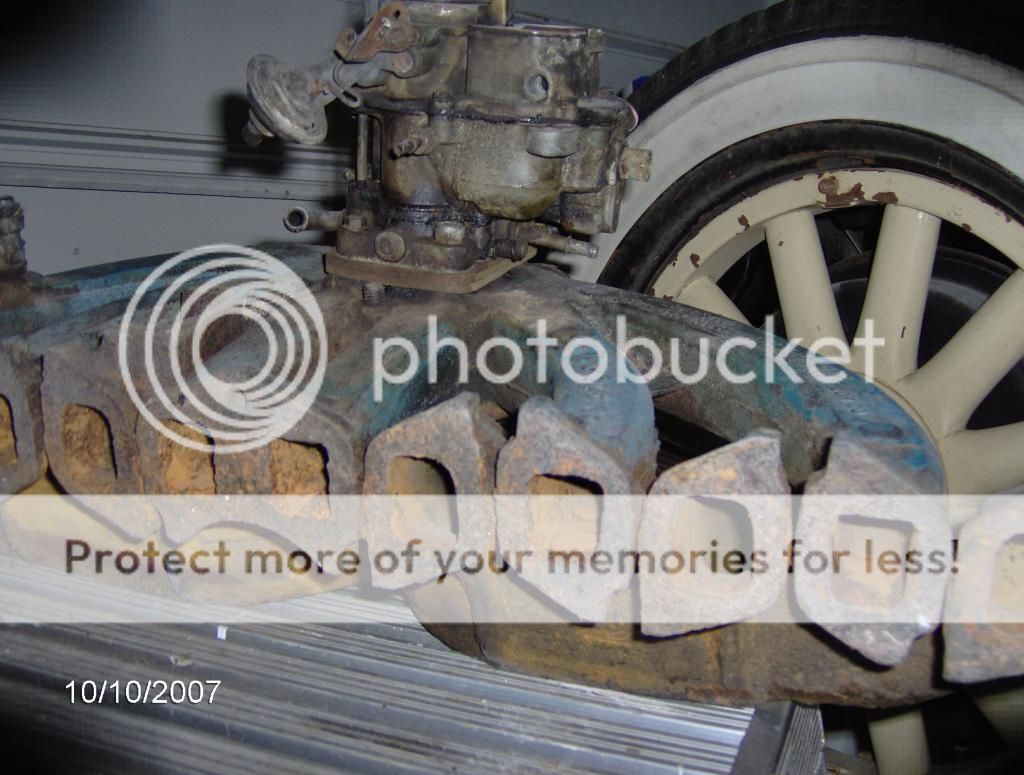

One more, this spare set-up evidently sat partially in water, the intake and exhaust have some major pitting at the head mating surfaces. I am guessing that this needs to be re-surfaced otherwise I may have a problem with leaks.
I am going to guess that regardless of whether I use this exhaust manifold or another ( it will prob be another ) that I should have them re-surfaced together as a unit?
Am I on the right track? What would be the correct procedure for getting these lined up prior to sending them to the machine shop, would it be......
A- bolt them onto my head first at the head end and then tighten the outer studs/bolt/nuts at the carb end
B- Send them off separately and let them re-surface and assume that I wont have any issues when bolting all this back together on the block?
C- It makes no difference how I do it

The intake manifold with sensor mount is intended for use with the LeanBurn setup, which came after the SuperSix was discontinued.

From looking at the books ,first year for the charge temperature switch CTS was 1979.Went on the manifold between between the vacuum fitting and flange. The spot where your finger is do not know.

http://www.slantsix.org/articles/supers ... aidout.jpg The Cts was used on both leanburn and non leanburn engines. Part of the egr system.

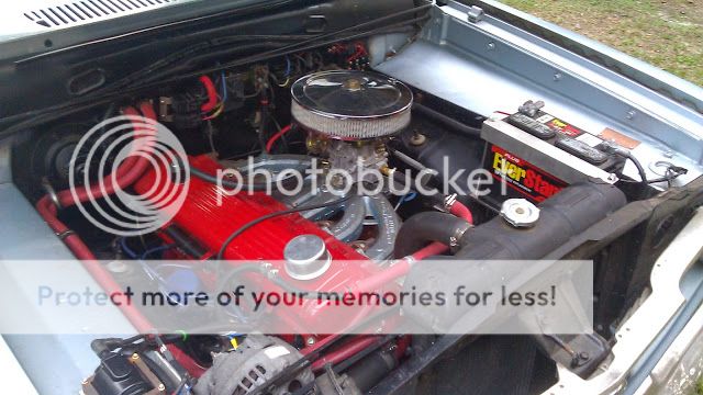

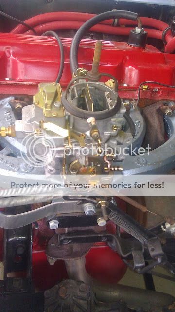

This is a 2280 super six set up. I have more pics if you want to see. Mark

I was thinking more along original equipment, two sources have different opinions and I am curious on the real scoop. Nice looking engine bay though. Good detail work

I would pick the intake and exhaust manifolds that you want to use, bolt them together loosely, install them on the head using the factory correct procedure, then remove them as a unit (without loosening the there bolts holding them together) and send the unit off to have the mounting face resurfaced.
