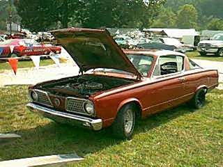

Hi all,
Just a quick accolade to Charlie S., in case anyone is curious: his little tiny 170 SL6 with a warm cam, headers, a 2 Bbl carb and 3.91 gears moves pretty darn well!
The glasspack mufflers are a tad raspy at idle and downright loud when the pedal hits the floor. Despite a serious cubic inch deficiency, it feels at least as strong as any 225 I've driven, probably a little more. I smiled my approval. Then he reached down among all the racing gauges and flicked a switch, and a little red light turned on. I raised a quizzical eyebrow. "Oh, that's just the arming for the nitrous bottle... Watch this!"
At probably 2500 rpm or so, he mashed the pedal. Lemme tell ya, that puppy breathing laughing gas will outrun my stock Mustang 5.0 without even thinking twice, even though it has about half the displacement.
It's a good thing he limited his showing off to high gear (the pavement was wet, so we didn't have much choice). In first gear, I suspect most of my internal bodily organs would have been rearranged... I suddenly realized why that car really needs high-back seats or headrests. Charlie, I hope you do that before you increase the Nitrous jets, OK? :)
I popped the hood when we got back, to make sure it really was only a slant 6 under there.
Wow. :)

Great post Erik, I'm sure Charlie will say thanks once he see this.
Charlie has certainly made good on his claim that he was going to get back into Slant Six Racing. He nailed "rookie of the year" honers in 2001 and made a number of impressive showings at a few 2002 points races.
I need to dig-out some other pics of his car.

I seen his car at the north wilkesboro slant six shootout. Charlie is a really nice guy and that
barracuda flatout honks!
