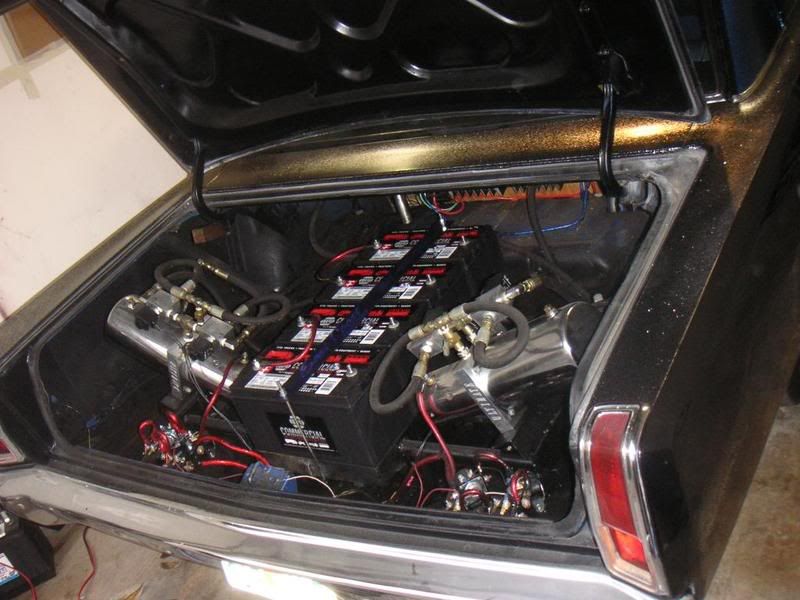

after re doing the hydraulic pump system in the trunk of the car ...

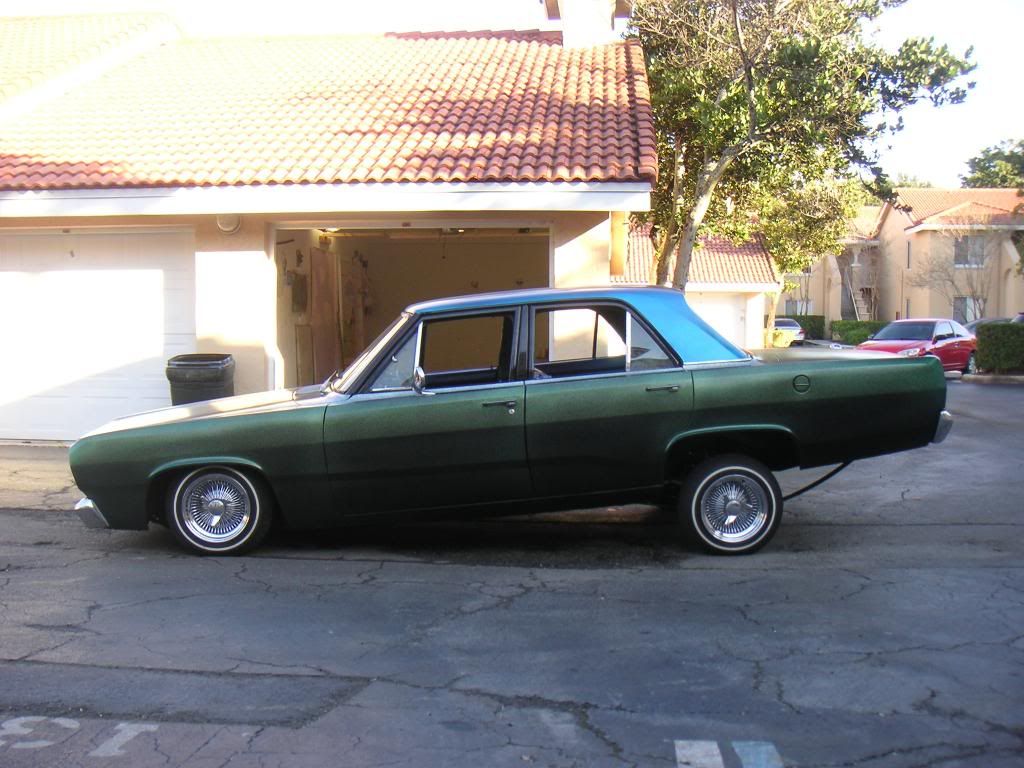

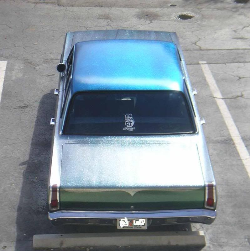

metalic flake painted car : as it sits right now before kandy paint and pinstripe graphics - wich are next on the paint list to do.

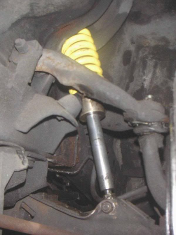

the front suspension was modified by removing the keys to the torson bars but leaving them in place - the front shock mount was utalized to install the hydraulic cylinders thru in coil over aplication. this area will be re enforced by welding 1/4" steel all around the perch to connect to the front sub frame for further streingth. right now its sketchy at best how long this configuration will last with the hydraulic abuse.

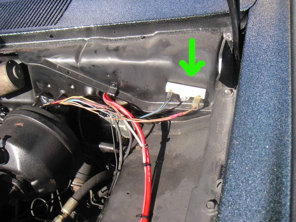

as for the engine's running - it was running like a top - until recently it decided to choke out at idle once it was warmed up. sputter down to like 4 or 5 hundred rpm in gear idling and stall out. I thought it was related to weak spark issue as from this piece here I had all kinds of varing readings with dmm.
going in I would have from 10v to 14v and coming out I would have from 3.2v up to 12.3v - so after replacing a bunch of crap including that piece / new coil / new plugs / cap and rotor and also tracking down all the wiring going to ignition pieces ive determined that the wiring is good for now - altho the wires them selves are old and yucky - they are not shorting out anywehre - and no wires are broken in connectivity.
the car runs again - after fixing the problem. I tested my old coil and it was a little bit out of factory specifications. the cap and rotor were pretty beat so im glad those got replaced also. I found it strange that the rotor was not held on by any screws or bolts.

If you are using the rear shock mounts for the hydraulic mount points, I hope you reinforce them.

Hi Brian,
A few things to check out - There are 2 different kinds of ballast resistors for the older mopars - a 2 blade kind for LEan burn and a 2 Blade kind w/o lean burn. Maybe check with a reputable parts store to make sure you have the correct Resistor on the car for your year. your can has no lean burn. These resistors look different from the factory but may be the same look outside from the aftermarket, but they have different ohm readings.

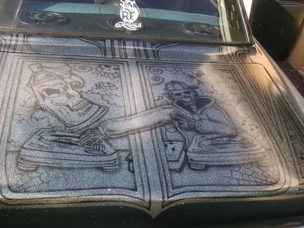

my brother drew ( shown in photo ) did some more painting on the car. I laid out all the tape design - he came in with air brush and sprayed.
again my digital camera will simply not take an acurate photo of the metal flake paint job it has. when the sun hits it its verry intense.

I have 2 hydraulic pumps - one goes to both left and right front
and the other goes to left and right rear.
so to raise up the car - I can go front up / back up
or whole car up at the same time.
once the car is up - I have 4 individual oil dump / return solenoids hooked to the hydraulic line so I have complete independent action on all 4 corners to lower the car how ever I see fit. side to side action included
