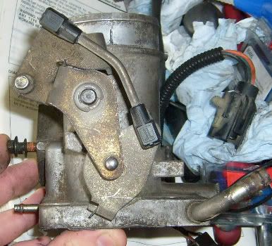

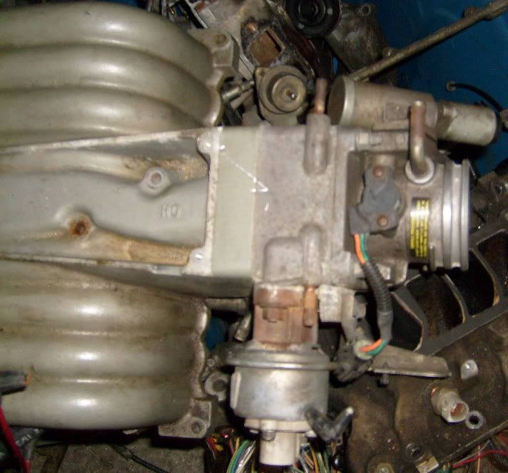

I just got done converting my 1989 Ford van from speed density to MAF fuel injection. I have learned a small bit about Ford throttle bodies in this process.
Ford used two style of throttle body in the late 80s to mid 90s. There is the large single bore passenger car style:
and the double bore truck and van style:
Both the truck and the passenger car style throttle bodies have vacuum fittings, have integral IAC valves, throttle position sensors, and have throttle and kickdown studs compatible with Lokar style throttle and kickdown cables.
Based on my experience, when I build the MPFI systems for the slants in my brother's Duster and his van I will be using the passenger car single bore style TB. This is mainly due to its square mounting bolt pattern and the much wider availability of factory and aftermarket air filter and air intake tube options. Also, Ford MAF sensors were only made in the large single bore style. I had to cobble together a home-made adapter to go from the double bore van throttle body to the single bore MAF sensor on my van. It works, but it isn't pretty.
