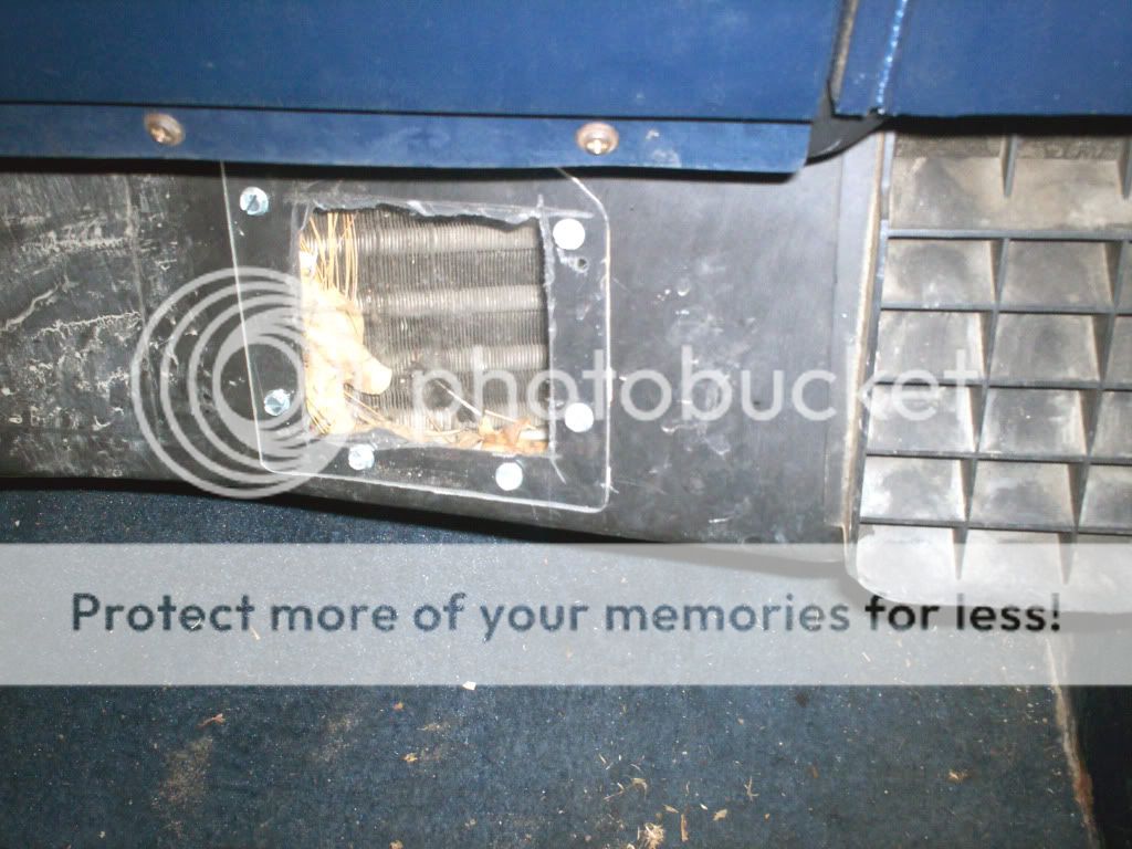

this is how i cleaned the heater box in my 84 D100. used cutoff wheel, not too deep, to create opening and cleaned with shop-vac., and covered hole with clear plexiglass. right after i bought this truck i had to replace radiator and flush repeatedly the heater core, finally a big bunch of goo came out. andy.
as you can see, already has some leaves and pine needles after one year.

Fortunately, the heater boxes on vans are extremely easy to remove and disassemble, especially if they don't have A/C. I won't need to cut any holes, thankfully.
