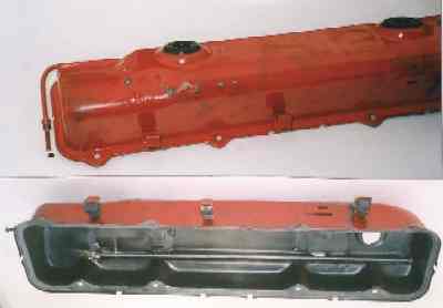

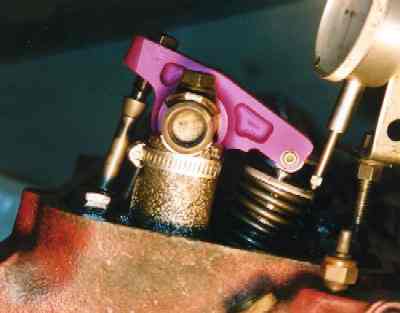

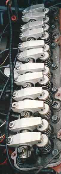

heres some pics i found while the old board was up still and i saved them, enjoy (they are actually quite interesting)
now what do you all think?? :D
P.S. Hey Doc, i'm sorry for using your images and hope you dont mind but there the only ones i can find, could you through your .02 in here??

What's that modification to the valve cover used with the roller rockers in the pictures below?

I know they say 'a picture is worth a thousand words', but I have more questions. The hose clamp around the rocker shaft pedestal, is that for holding the rocker shaft shims in? Are the rockers bushed, or are there needle roller bearings for the shaft. Is there a seal on each side of each rocker to hold/ or restrict the oil so that it is pressurized, or is it just a 'controlled leak'? Do they take a special shaft or is the stock OEM shaft OK? I see you have a drip oiler manifold rigged to oil the roller tips, is there any other way to get oil to the tips? Why are the shims needed?

well first of all i'd like to clear some things up, i don't have rollers yet although i have made the valve cover for them i need to set up the rollers that i plan to buy...you need a drip type oiler for the tips b/c there is no other way that i know of to get oil to the tips adequately enough to do anything, i think when you buy the roller rockers it comes with shaft and all b/c from what i see you cannot use the OEM shaft, the shims are needed to hold the 1.6 rocker ratio i think, i don't really know much about them again this is all from my speculation....

The Rocker Arm Specialist roller tip rockers have a bronze bushing that rides on the stock size shaft, the ones I got look like the shaft has been hard chromed and reground. The close fit between the rocker arm and shaft is tight enough to prevent excess oil bleed-off out the sides. Overall, these rocker arms are well made.
I use a special oil rail installed in the valve cover just because I want lots of oil right on the roller tip and valve. I find that this helps cool the exhaust valves as well as prevents valve gear wear. The Alm. Roller Tip Rocker Arms do have oil feed holes running up to the roller tip but it has to stop just before the roller. With the roller tip being the high point on a Slant Six, I am unsure how much oil will "splash" up to the tip, I don't want to be "unsure" so in goes the direct oiler, the rocker arm and valve now gets lots of oil.
As for the shaft shims and the hose clamp in this photo:
http://www.dutra.org/pictures/engine/pa ... easure.jpg
The shims are needed to get the valve tip contact geometry correct. (roller contact centered on the valve tip) I could have shortened the valve stem to achieve the same result but the shims are easier to adjust.
The down side of thick shims is they act as a wedge in the head's rocker shaft saddle and can crack / split the cast iron head's rocker tower. The tower in the photo is cracked and the hose clamp is there to prevent it from spreading open and loosing grip on the bolt.
