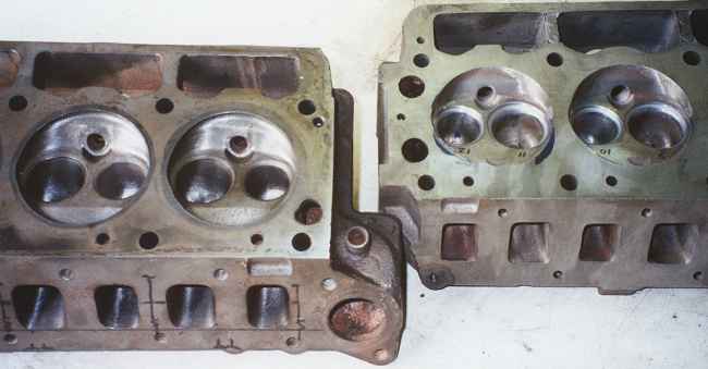

To set-up a quench area in a 225 SL6 your best bet is to get an early (60-67) head and angle mill it, taking most of the material off the manifold (port) side.
Doing that will give you a flat area to work with.

Doc, yes, that's exactly what I'm looking to do. The head in the pic, can you tell me what angle was used and how much cut?

I have done up to 0.210" on the plug side and 0.110" on the manifold side on an early head. No problems even with multiple head swaps. That giave me 33 cc semi-closed chamber with SB Chev valves.

Did you mean .210 on the manifold side and .110 on the plug side? Seems to me you'd want the semi closed chamber on the side away from the plug (to force the mixture toward the plug).

I meant what I said. Doc's suggestion may work better. I have run up to 11:1 comfortably on pump premium with that head and a big cam (250 @ 0.050").
I might worry about deck thickness when doing 0.200"+ on the intake side. On the plug side, you mostly have the pushrod opening and no water jacket for 2" in from the edge.

When you angle mill the head, do you angle mill the stud holes on the other side?
