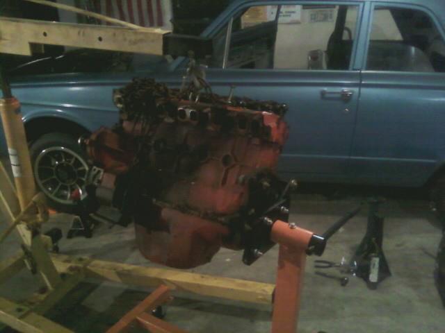

It's out! Thanks for the advice, everyone! We ended up using washers and grade 8 bolts, just to be sure.
I'm still trying to figure out the best way to center the engine on the stand, that's why it's still also on the hoist. That's another job for another day, though.

PostPosted: Wed Jan 18, 2012 9:41 pm
6 Pack Dart
Posts: 2281
Location: Eugene, Oregon
I could not get mine centered on the crankshaft center line. Always was crankshaft just below but centered on the stand.

Yeah, the Slant doesn't lend itself well to stand mounting, unfortunately. It's centered now, but a lower angle would most likely be better. Thanks for the tip.
Chuck and the Flying Valiant
PostPosted: Thu Jan 19, 2012 5:32 am
Posts: 202
Location: Orange County, CA
Yeah, it's a bit top-heavy on the stand, so be very careful when rotating it or moving it around.
