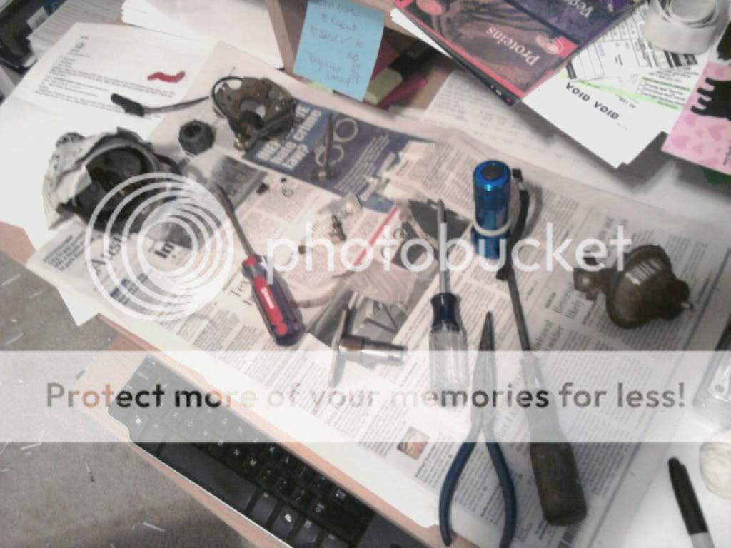

Got my distributor today. This is my first ever attempt at doing a recurve. I got an 876 Dist,it is used but has no shaft play, and the gap looked great all the way around,so its nice and straight. Sorry for the bad quality pictures,its from my phone.
My work station:

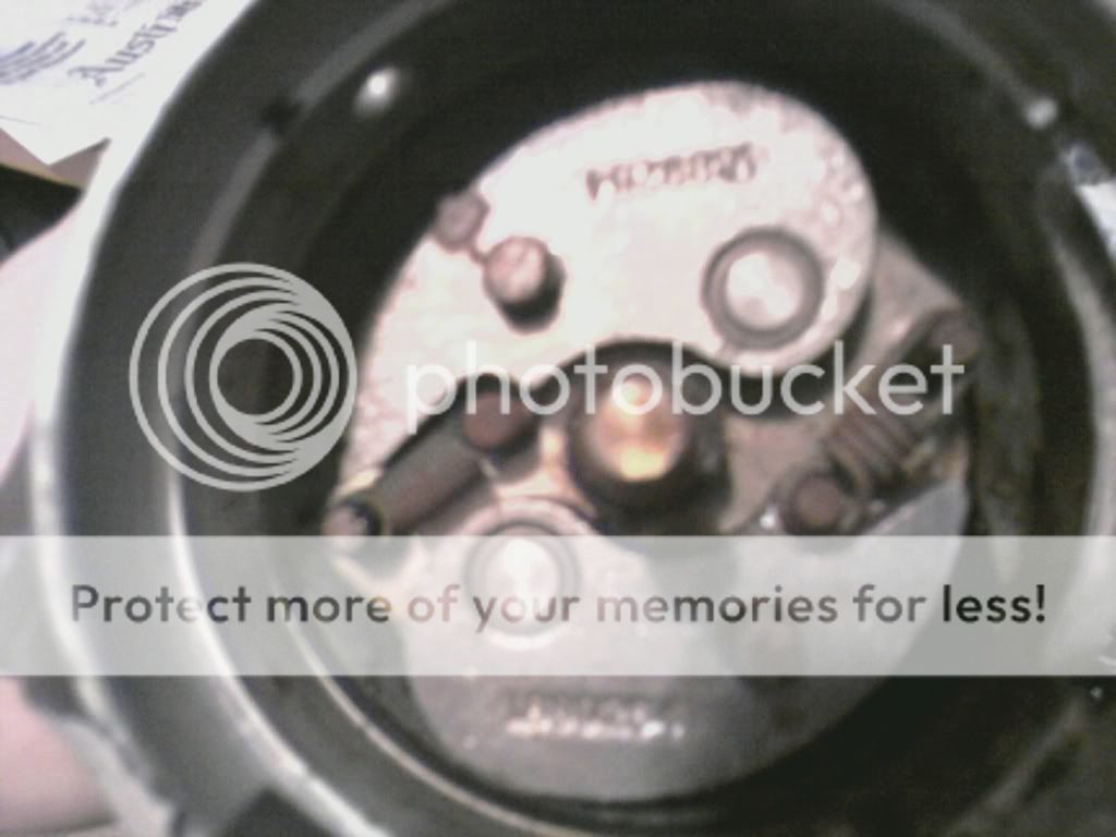

Inside the torn down dist:

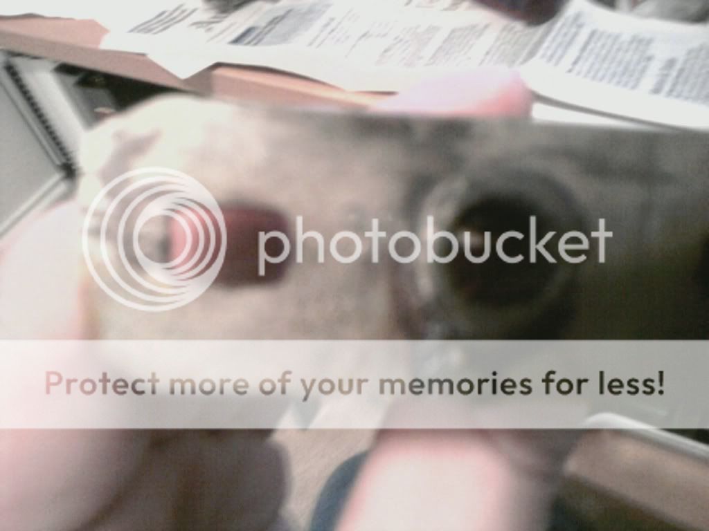

I was excited to find the 9R gov:

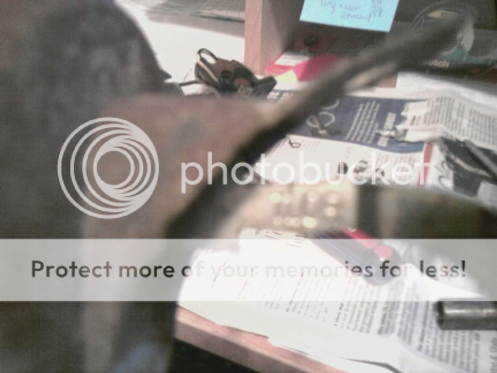

Not sure if the 11OR vac can is any good to use:

First things first I want to clean and relube everything. What is the best stuff to use for relubing?
What do you guys think of the Vac can?
This is all going in an 87 D100 with a stock motor,with a Weiand 4bbl,eddy 500,and hooker long tube headers. Backed by an 833 OD and 4.56 gears. I will be bumping up the compression,and going with a .5XX lift cam prob some time next year. I figure I will need to recurve then.
I have bigslant6fan's spring kit. I have read his write up a few times. My only trouble is I dont have a welder or welding skills. I need to know if I can just change the springs,clean and relube and just run it without modifying the slots like mentioned in his write up?
He recommended One green and one blue spring as a starting point. Any thoughts?

I have avoided any grease since it will dry out and become stiff over time.......I use 5-50W Castrol synthetic oil only.
Keep that heavy long looped secondary spring and start with the green spring from the kit for the primary spring.
Set at 6 degrees initial with 18 degrees mechanical (24 total) the 11R can should be fine to start with. You can always change it later if you have to.

The primary spring is green now,is it different in the one in the kit,or the same?
It should be the same, but on re-mananufactured distributors they seem not to be consistent tension and maybe stretched out.
Use the kit green one first, then go stiffer from there. I wouldn't worry about shortening the slots to start off with especially since you have blues and blacks to really slow down the advance.
You have the long looped heavy secondary spring to stop the advance at 3000 rpm. I doubt you would be hitting the ends of the slots....

I think the secondary spring is too strong, I don't think it will be very useful. The 9R advance plate is close to ideal,leave it as-is, and try one green and one blue spring for a stock cam. You might also consider useing one or two steps colder spark plugs,since you've vastly improved the intake and exhaust system.
