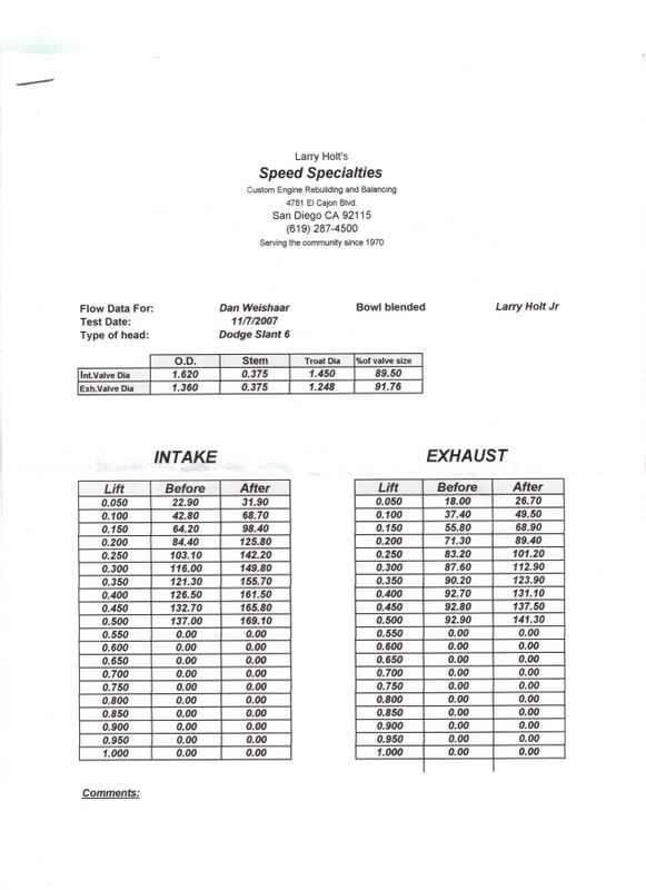

Here is the head currently on my car:
If I remember correctly, it has had .1 shaved off of it as well. I just got a line on a correct-direction marine motor, so I'm going to start slapping this thing together, hopefully in time for MATS. This car is going to be an autocross/track day car, if all goes well we may even take it to Pan America this year as well as Boneville. I have an erson cam as well as a blank I can send out fro grinding. I plan to make a 3x1bbl intake that a linked previously:

Nice gains there with stock valves. What fuel will you run? What HP or track performance are you after? Max RPM desired? Budget for long block? These will affect recommendations...

I don't plan on spending more than a couple hundred. Cam, enough machining to clean anything gross up, and new bearings. I'd like to be able to run on crappy 91, due to the probability of Mexican gas running through it.
I'm not too interested in max RPM, so much as being able to idle on the idle circuit and average RPM and a good broad torque curve.
I guess I just really need to know what kind of cam the Argentinians are running......
