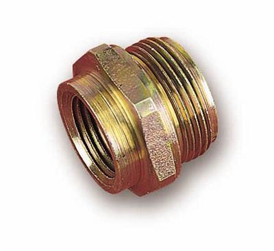

I just got a 750 Holley To try out on ruster.
Having never messed with a holley carb other than stock 1bbl stuff..
I ham having a fuel drip-leak issue with the 3/8 Inverted flare fittings that go into the fuel bowl.
is there supposed to be a gasket in on both sides of Holley part # 26-26?
I have the large 7/8" gasket on both the front and rear bowls... But is there a gasket that goes in the flare fitting location as well?
If we look at holley part #26-26 from the summit racing site, it has both the large and a small gasket pictured... Is my lack of having these small gaskets causing my fuel drip??
I have never needed to use a gasket on any other flare fitting I have used before so this is kind of giving me a challenge to get the leaks sealed up.

Greg, I have never used anything but the larger O ring type seal on the bowl side of the fitting.

Nope just the bowl gasket.. Sounds to me like a flaw of some kind in the line... I am not familiar with your build or carb, but a 750 is a pretty large carb...
Are you using just "stubs" and rubber hoses or the dual feed line? After time the feed lines do seem to "develop" leaks.

I am using the Fuel line kit, not the stubs and rubber hoses.. ordered 2 new part # 26-26's Maybve I over tightned the first time and caused a leak... also Tha carb was used so maybe there is other junk going on.

THe Flares were not sealing correctly against the inside of the fitting.. Seems like a common problem..
I made my own flares on some 3/8" tube stock and left a little "cushion" in the flare so it would seal against the holley 26-26 Fitting.. The little cork gasket is for a holley ceramic fuel filter in the fuel bowls.. and You are never supposed to use pipe dope or teflon on flare threads - THe threads do not seal like in a pipe fitting.. THe flare does.
As I have never ever had any trouble with any of the 3/16" flares for brakes etc.. I was second guessing the 3/8" flares.. But I got it all figured out now.
