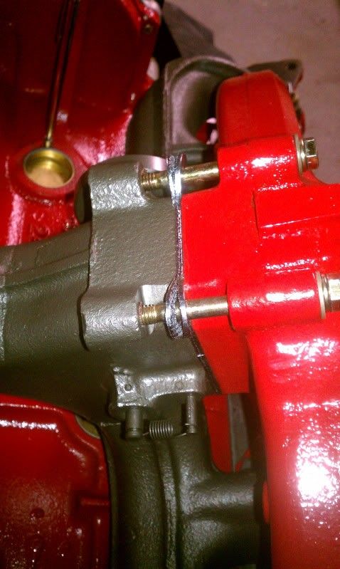

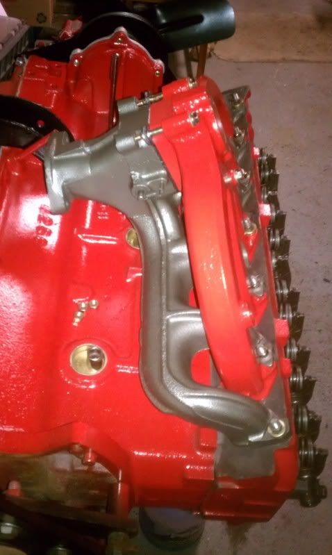

so i finally got around to getting my exhaust manifold blasted, and painted up, ready for a mockup. i got my self the remflex setup, both heat riser, and manifold to head.
anyways i started mocking up the 2 manifolds as per the article. attached the 2 manifolds with the hotbox gasket, with 3 bolts hand tight. then layed it down on the head, and started from the center out, just hardly snug at all. then went back to the 3 manifold/manifold bolts, and torqued them down to 22ftlbs. as the article states. i slowly torqued them, from 15, to 18, to 20, then 22. so i didnt tight one side too much.
then i noticed that the ears of the gasket split, now im not sure if this is normal for this style of gasket (i never used a graphite gasket before), and is common, and people had no issues of running it as is, or should I tear it all back apart, and put a new gasket in place... but im sure it would just happen again. input?? thank you friends
manifold is painted with a high temp cast iron color paint, i think it looks great.

Leave it and run it. The important part is the gasket at the hotbox flanges, not the ears.

i was just thinking maybe somehow the gasket would start to split all the way around, then burn out.. but i guess its good to go.

Yup, it's normal and fine.
