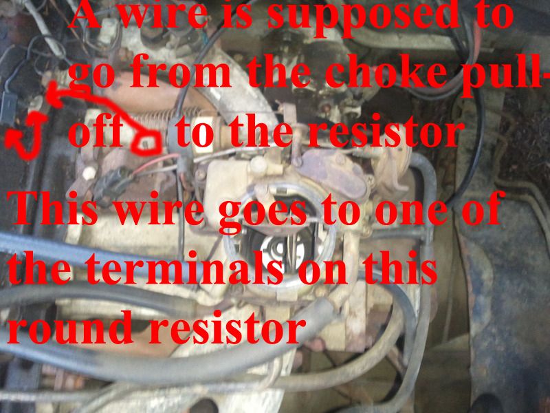

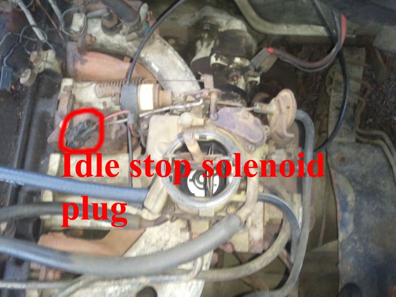

Per popular request, I'm consolidating the carb details from my "parts wanted" post to here.
I was trying to find out what type of carb I have VS what would be best for a stock setup.
Here are the pictures I was able to snap:
I have no idea where these go...
Thanks!
1985 D100 3.7L Slant 6, 4-speed manual.

(1) No luck on the air pump. I know I used to have one, but I can't find it in my garage anymore. I MIGHT have it in my storage unit, and I will be getting in there this weekend, most likely. I'l look there.
(2) Image
(3) Image
(4) Image Image Image
The idle stop solenoid is the plug next to the voltage regulator in the wiring diagram I posted. Those diagrams are from a 1983 Dodge factory service manual for a van, but a truck wiring harness should be near identical.
You are missing a wire that goes from the choke pulloff (thermostat?) to the round resistor bolted to the head. The other other wire you don't know where it goes also goes to the round resistor.
At some point in time, there was a plug in your original wiring harness that went to the idle stop solenoid, unless someone swapped on a different carburetor and left the idle stop solenoid. It is very worth it to have a functional idle stop solenoid, if possible. See if you can't find the plug that goes to the ISS. I can post the factory correct method to set your idle speed if you get your ISS working.
Let me know if this all makes sense, or doesn't.

Still, it looks like the wire that goes to the round resistor has broken off dc's choke thermostat and a new one needs to be soldered on or the unit needs to be replaced.
