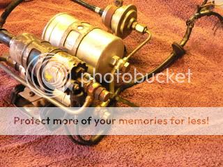

I hit the jackpot and found this series pump assembly at the junkyard for 16.00. Its from an 88 Mercedes.
I'll try to use a stock Ford in tank to prime them.
i also found a Volvo solo unit for the same price, so i grabbed it, too.
