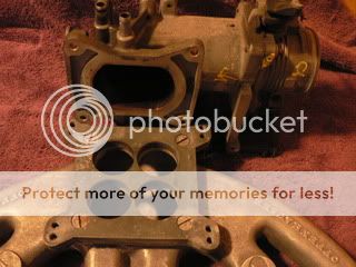

I have found three different throttle body elbows, each has potential benefits. Any suggestions?
I'm installing a blow through MAF which works best in a long straight section of pipe. The intercooler I'm looking at will discharge behind grill passenger side.
The stock ford has a split plenum, log style upper intake with a 2BBL TB.
I'll be using an Offy 4 BBL.
The oblong outlet seems like the best choice for even flow, but I'm only guessing. The low profile and forward mount are pluses for housekeeping.
1960 Seneca 225 turbo soon to be EFI

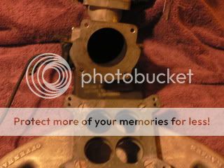

PostPosted: Wed Dec 05, 2012 3:31 pm
Joined: Sat Feb 13, 2010 6:20 am
Posts: 202
Location: Hammond In.
This one faces sideways and has the most exaggerated oval outlet.

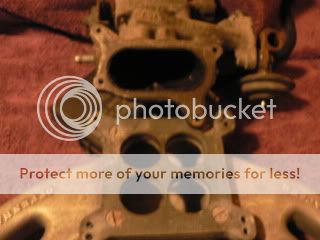

PostPosted: Wed Dec 05, 2012 3:34 pm
Posts: 202
This one, being round could be clocked in any direction. It's the tallest option as well.
PostPosted: Wed Dec 05, 2012 4:12 pm
Posts: 13431

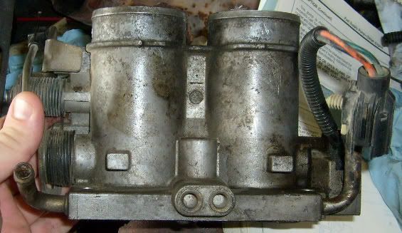

Ford makes the single barrel throttle body on the passenger cars and the double barrel throttle body on the trucks and vans.
Single barrel:
Double barrel:
I plan on using the single barrel version on the MAF injection system on my brother's Duster for simplicities sake. There are far more aftermarket plumbing options for the single barrel throttle body than for the double barrel, and there must be an absolute airtight tract between the MAF sensor and the intake manifold. I am itching to try a speed density conversion on my brother's van which will use the double barrel throttle body.
The problem with the double barrel throttle body is that Ford never made double barrel MAF sensors. There is a one year and California emissions package only factory adapter that mates the double barrel throttle body to the single barrel MAF sensor, but those are hard to find. When I converted my van from speed density to MAF I had to cobble up a home-made intake duct and adapter from aftermarket parts and a 1996 Ford truck piece:
The Ford truck adapter piece I used is close, but not an exact match to what is needed to adapt the double barrel throttle body to single barrel MAF sensor. I had to get creative with RTV sealant, hose clamps, and muffler pipe sections inserted into the thin plastic tube.
I would clear out the plenum on the offy and run a plate to mount the single barrel throttle body.
How are you dealing with EGR?

The 4.9 2 BBL TB has 2 39MM outlets, too restrictive. Of the three 1 BBLs I have, the first one seems like a good place to start.
EGR will be disabled.
