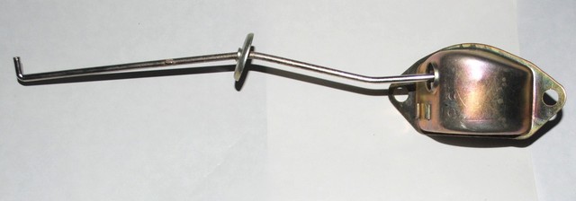

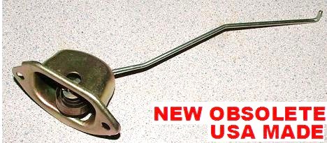

I will look for a 1234 electric choke, but what I've done in the mean time is order a (non-electric) divorced choke for a BBS. I will report back here on whether it fits into the choke pocket on my car's manifold. This will, at least, answer my original question!
Here's what I ordered:
http://i.ebayimg.com/t/CHOKE-THERMOSTAT ... ~60_12.JPG
http://i.ebayimg.com/t/CHOKE-THERMOSTAT ... ~60_58.JPG

I got a holt of the BBS choke, here it is bolted to the '75 manifold. It aligns as it should, I believe. At first I thought the rod was too long but now I wonder if that is intentional, to give me the ability to put a bend in it to make it fit my application. What do you think?
I am not sure this does anything that the original Holley choke didn't do, since they are both bi-metallic springs. The Holley had the voltage assist going to it, and again I do not know what the voltage was doing to assist it. As you can tell I still have a lot to learn about chokes. That's partly why I am doing this exercise. Cold starting being the other, of course.
I emailed Carlos at CarbsOnly and got a similar response. I figure 8 weeks translates to 6 months and if it is back in stock then I'll consider it. Meanwhile it is colder than a titches wit and I am looking for better perfomance now.
