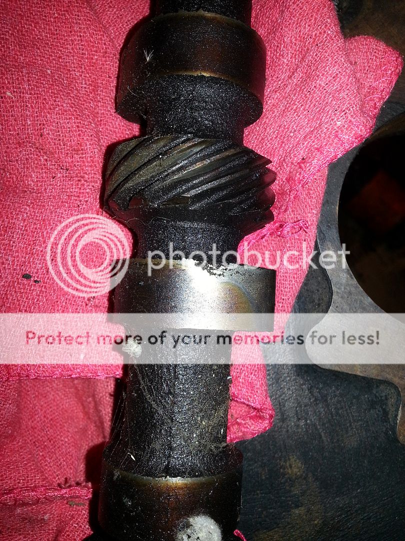

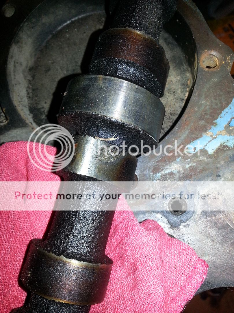

Okay so here are a couple of pictures of a camshaft I want to use as a core for a regrind. Does this look like damage and if so does it look to far gone?
This is 2 different spots.

looks to me like the casting had some voids.

That amount of wear is common on a high mileage SL6 cam and it will "grind-out".
More important is wear on the fuel pump eccentric, most regrinders do not like to regrind the FP eccentric so any wear there is a problem.

Could You chuck it up in a lathe and Do the Fuel Pump eccentric by your self with some Emery cloth?
